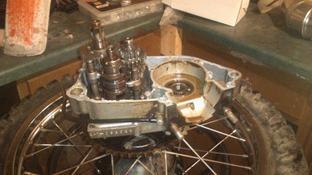

Here is the transmission side of the crank, everything is in good shape and there is no need to replace. The other side is in good shape as well, just in the parts wash tank for a good soaking.
I have good news to, the guy who split the case said he would also bore the cylinder and wiseco makes an oversized piston that will take it from a 175 to a 190. Im definitely going to bore it and make it a strong trail bike.

Yeah, I think im just going to bore it to the 180 kit, that way I dont have to do anything to the head, or just leave it alone. I dont know yet, it all depends on what my wallet says at the time.
Depending on the condition of the cylinder (inside) It might be worth it to just have it re-sleeved to the 175. Or replated. Im assuming that because of the age of the bike it has a steel sleeve and not a nikasil plating.:noidea:
its steel. There is a small rust spot on the cylinder wall that is a little pitted. I will have to bore it to get rid of it. I will have to go with the 180 kit to get rid of it completely, I dont know it the 176 would be enough to cover it.

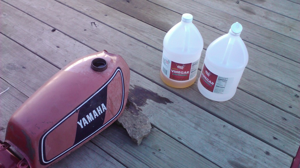

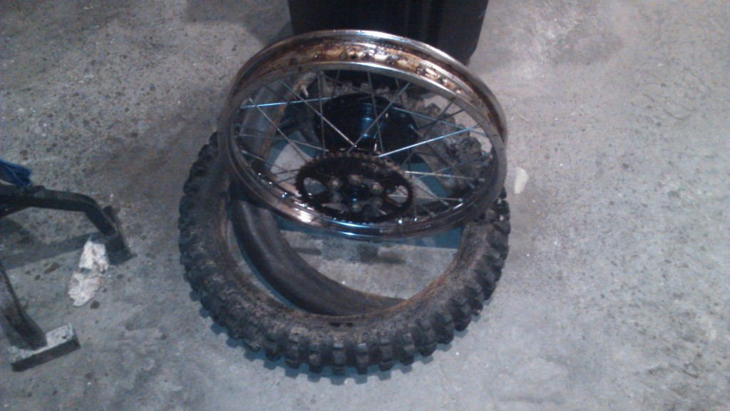

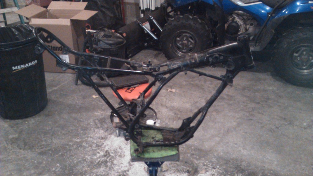

I got a bit of work done today on it. I stripped it down to the frame, put apple cider vinegar in the tank to get rid of the rust, and dismounted the tires. Everything is looking good, should be able to use most of the original parts. I found a guy in the next town over that has 10 of these things lying around so he said to come on over and strip of any parts I need, he has the 125s to so I should be able to get the yellow plastics I need.
Poor mans rust remover :smirk:. Let it sit for a few days and it should be rust free for the most part. I forgot the before picture :banghead:
