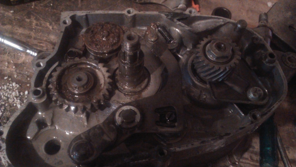

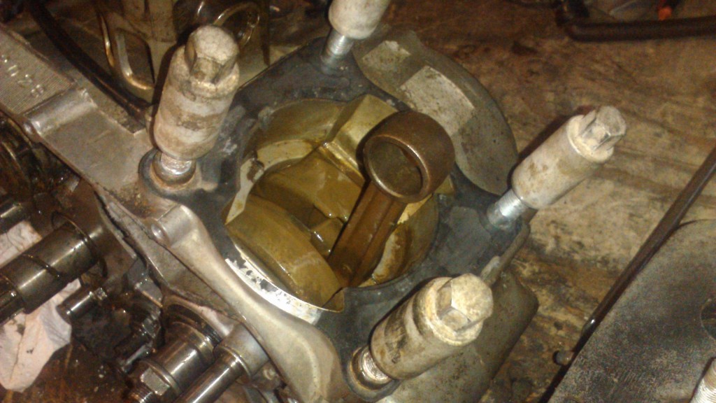

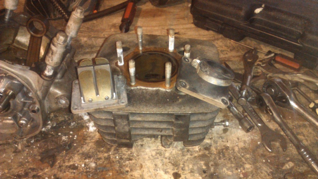

tore the engine apart tonight, I did everything but split the case. I convinced a co worker to do it for me for a case of Coors-Light :smirk:.
Anyway that will be done on Thursday. I found all the parts to rebuild it and with my discount at the Yami shop I can rebuild it with all new parts for $200, without it its well over $300 for everything. This includes clutch kit, piston kit, crank case bearings, reeds, and all the other good stuff. I have all the parts in little baggies and labeled so I don't misplace them. The clutch plates are worn to nothing so that's on the list to be replaced. The oil was in there for a while so it turned to snot and has to be cleaned out.
Everything just needs a little cleaning

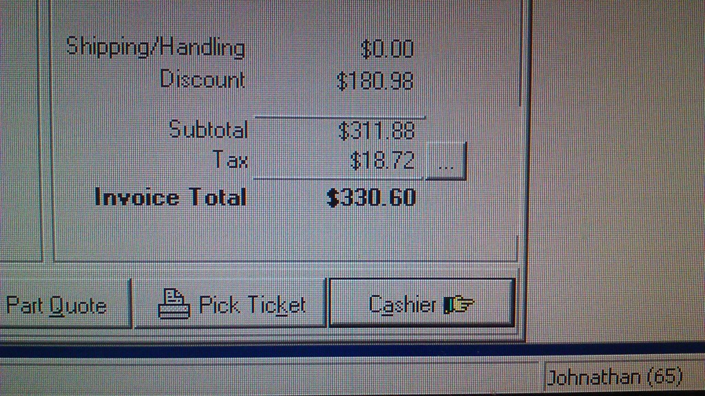

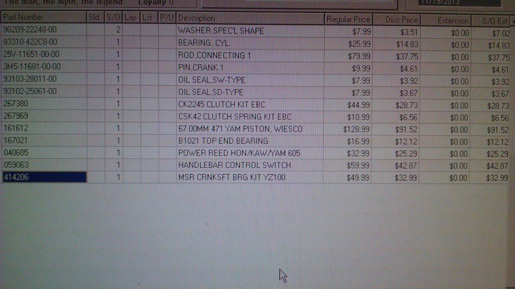

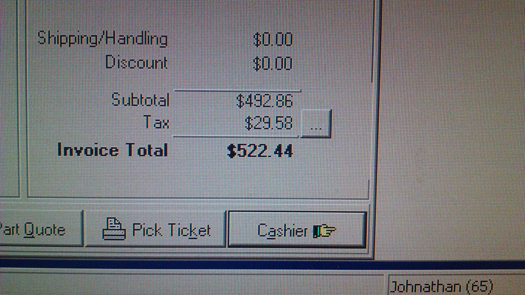

Update on engine rebuild price. After spiting the case today, instead of thursday, we looked it over and saw that it needed a few extra things. The oil seals of course, the crank bearings, connecting rod, and a few more important things. Luckily the transmission was in great shape. I will get pictures of the motor later but below is the list I need and the price with and without my discounts.
The List, The gasket set is unavailable through new stock so I ordered it from Yambits on ebay from their new old stock.
Price without discount $522.44
Price with discount $330.60. That's a savings of $191.84! Pretty damn good.
