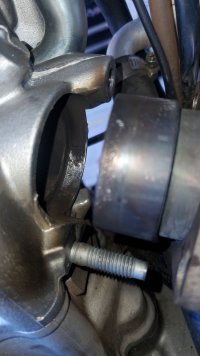

This extended end, is that considered the gasket? Otherwise there is nothing else here, just the pipe.
(Second photo) It doesnt even look like its room to sit a seal/gasket there?

Can you explain what that is?

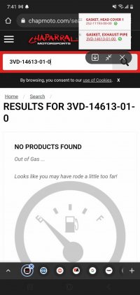

I never had one of those seals in my exhaust. Because of the extending edge on my exhaust, it doesnt even look like it has room to fit but I will buy one from Partzilla since Chapparral doesnt even have that part number in their system.

HaHa, you asked if there is a quick way to tell if there is an exhaust leak at the header....
The photo you posted answers that pretty quickly.
Ok, lol. Closer to figuring out my problem. Good news finally. Ima order seal now. Its no dirt bike shops up here that actually sell gaskets and seals. I was willing to drive to Chapparral but I guess because that part is somewhat "new" as manual said, Chapparral dont have part number in their system. Might try giving them a call tomorrow morning
