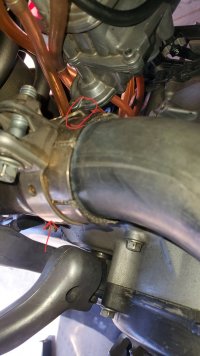

I had this too far down, where the curved tip circled isnt seated at top like it should. Seems like that could possibly let out some air. Enough to result in poppin?
No, probably not the culprit. That gasket looks pretty good too.

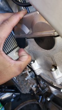

What I noticed when getting ready to put valve/cam cover back on is that Im able to pull back gasket on exhuast side with my finger.Not able to pull back intake side. Is it a chance air can seap thru enough to cause popping?
Interesting, You checked the valves after running it for a bit? Valves could also 100% be an issue. I didn't realize this is a fresh build. I wrongly assumed a new issue. If they are correct, they are correct, though.
That oil seal is to the crankcase and not involved in the engine fueling.

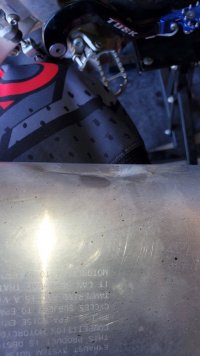

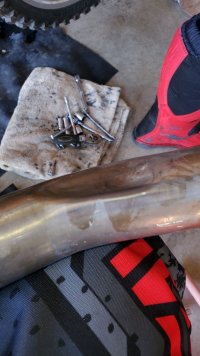

Gotta ask because I dont know, so just want to eliminate all possibilities.
These 2 dents in exhaust can or cannot contribute to the popping?
