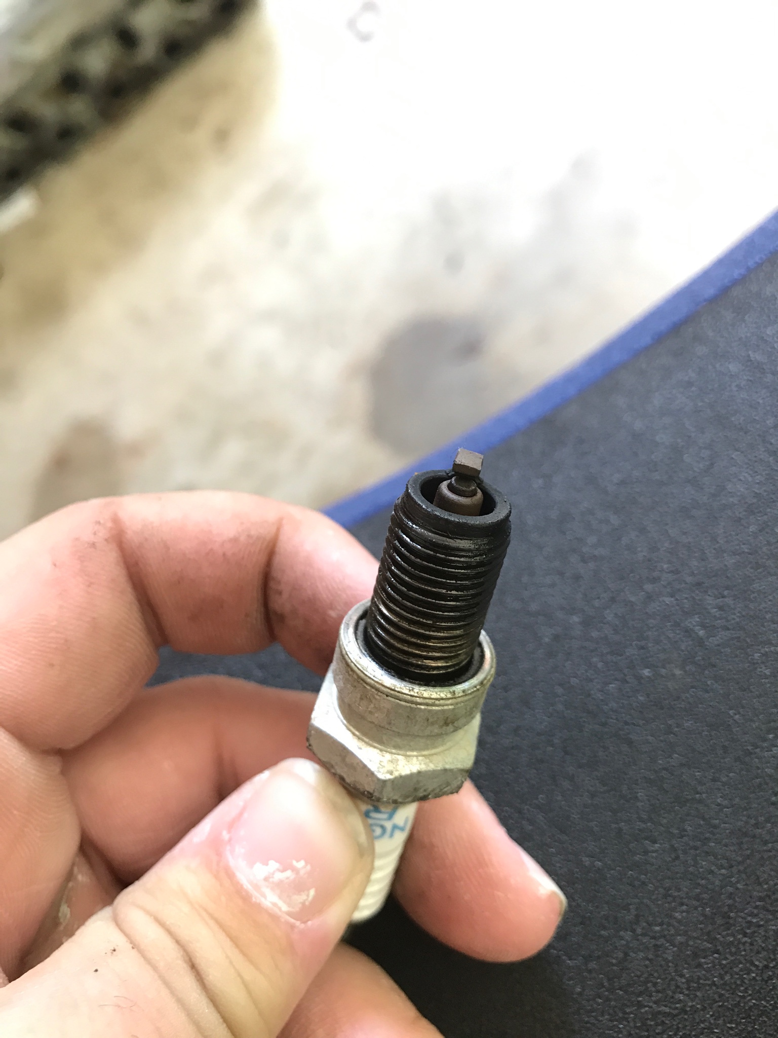

Got a photo of that spark plug?
I don't have a pic of the plug. Why do you need it? I did discover that the fuel cutoff doesn't work. I'm hoping it's just constantly flooding the carbs. That and there's probably some sort of trash caught in the carbs. I'm getting a compression test tool from my in-law so I'll check that later today.

A pic of the end of your spark plug tells its own story of what's going on during combustion/firing, so pull the plug, take a good pic of the end of it and one of the very highly experienced guys already helping will be able to give a decent diagnosis!
