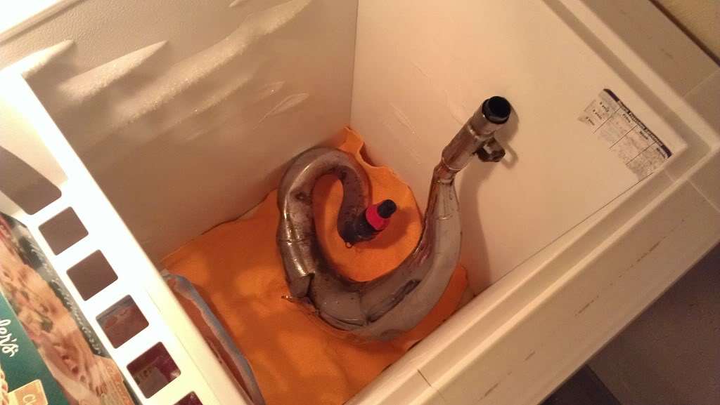

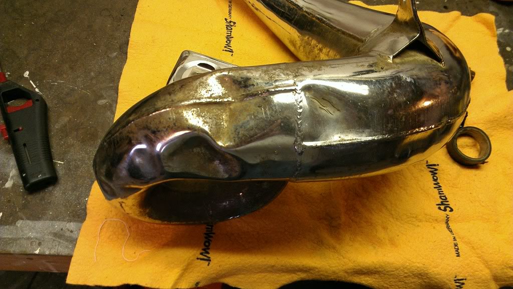

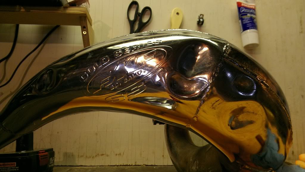

My expansion pipe has looked like shit since the day I picked my bike up. Today I decided to do something about it.
