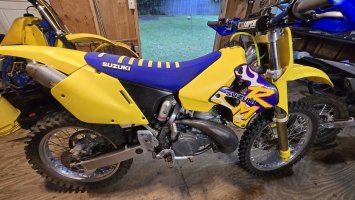

Coach's project continues!

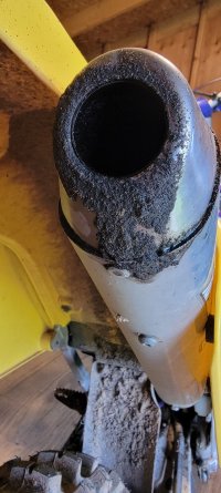

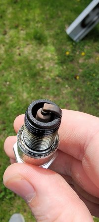

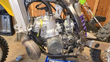

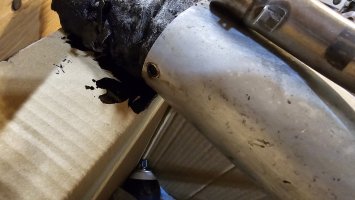

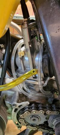

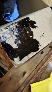

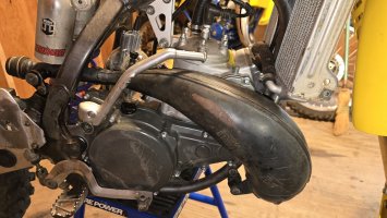

I pulled the factory pj38 carb, just couldn't get it idling and running right. I swapped in a pwk38 and used some jetting specs from a person who has done this swap before. 52 pilot, dgk needle on the 3rd clip, and 172 main. I am very happy with the outcome, the bike idles now, and it's a little fat up top. I think I either drop the needle 1 clip position or drop the main to a 170.

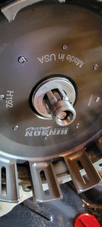

The bike appears to be running really well from the plug, but the silencer says differently! And I got my hinson basket installed today too!

So I dropped my pilot as it's been warming up here finally. The jetting is pretty close, but I still can't quite get the bike to consistently idle. It's loading up a bit, but under load it clears up almost immediately. I've been messing with my mix screw and kind of adjusting my idle up and down but I can't quite seem to get it. My digital tach that I've got installed now says in hovers around 2k rpms for a few seconds, then slowly idles down and stalls. Any recommendations?

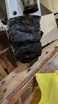

Today is maintenance day! Repacked the silencer, adjusted my carb, lubed my chain, and did a detailed look over the bike for loose bolts or anything like that. The packing in the silencer was long over due

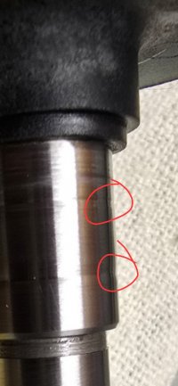

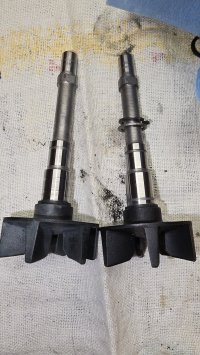

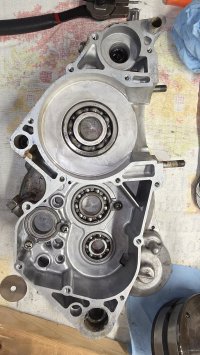

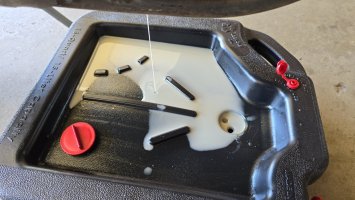

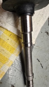

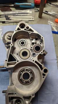

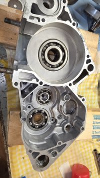

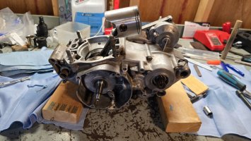

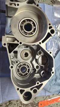

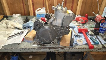

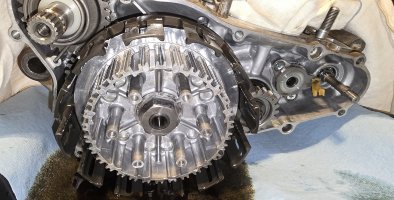

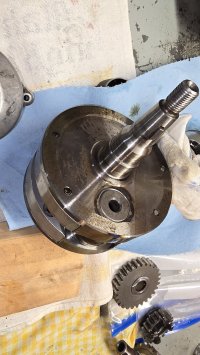

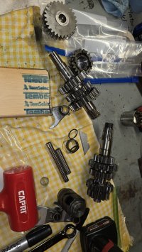

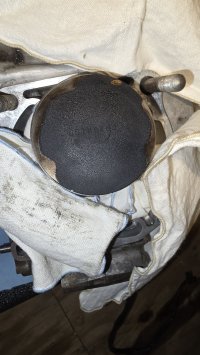

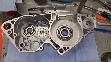

Big update. Waterpump seal decided to check out. Engine has approximately 20hrs on the top end, crank has no play in the big end bearing, and deflection on the rod is about 1.5mm. Cylinder and piston look good, reeds are wore out, so I replaced those. I split the bottom end and did a thorough inspection. Upon inspection all of the bearings were marginal or ready to be replaced. I figured out everything in the bottom end is original, I am the first person to split the cases. So I decided to just replace everything. Got half of the bearings installed, still waiting on the rest.

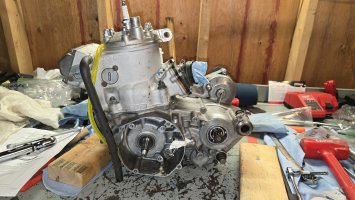

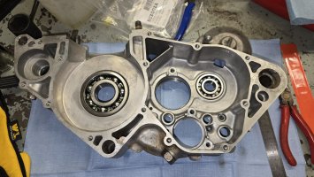

Another big day! Got the rest of my bearings installed and reassembled the engine. I realized that I forgot to order an output shaft seal. So that will be here mid next week. Other than that it was a successful day.

Okay hopefully final update on this portion of my process. Got the bike back together, all new bearings, new water pump and seal, new reeds and one repair set of threads.
