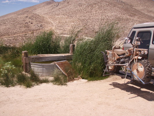

Wait,,,,are you riding something with a rigid frame? Totegote or Rokon?
Turnbuckles and chain keeps the TrailBreaker on the back rack. I don't have any suspension to pre-load, only tire squish. I can't have anything stretch or flex.
Hey, that was why I was asking Kyle. When you fasten something like a loader onto a trailer, some like to drop some tire pressure, winch down. Put on chain binders if they are going to be used and then pressure up again. Knowing how much to put back in is pretty important.
