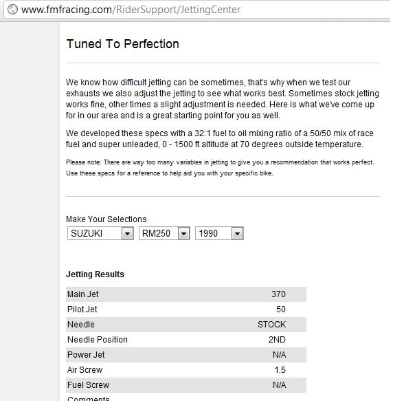

This is what FMF calls for... It wont be exact because every bike/climate is different, but should get you in the ball park.

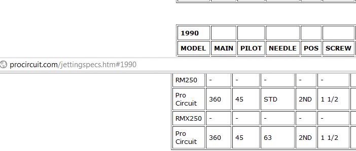

This is what pro-circuit calls for with there pipe.
I think you already went over this with 2smoke earlier in the thread ... I just remember'd as im typing this... But figured i would leave this with you :D.
