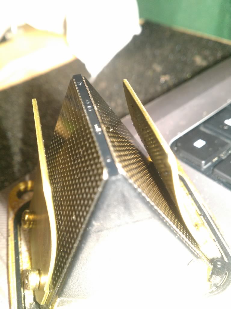

Well I hesitate to tell you, but......... When I got my bike it ran just fine when I first got it. It was jetted pretty close for the time of the year also. Then summer time rolled around and I started to lean it out for the air temperature. Everything was fine till late summer. Then it developed a rich condition that wouldnt go away no matter how lean I jetted it. So I figured it was time for a new top end. So I replaced the top end and rejetted the carb for the elevation and temp and started my break in. Well it was a little to rich during the break in process so I started leaning the jetts out and no matter how lean I went on the jetts it was still way to rich, and it was a major pain in the ass to start. So I started asking questions just like youve done. Long story short I found out that the Nikasil coating that the cylinder is coated with was just plain old worn out. After all at the time it was like 16 years old. So I tore the engine down stripped all the steel parts off of it and sent it off get it replated. $500 dollars later I had a more or less new cylinder. Put a new top end in it again and its ran like a charm ever since.

so i put a new plug gapped to .024, put new boysen power reeds in, rejetted to a .360 main and .45 pilot and 1.5 turns out on the adj screw, and checked the carb seals and there both still good and still nothing it wont start...
when i put the top end in it was sleeved so i just got it bored out and put the new piston in never got it recoated but i don't see how that would matter....

Well when you pull the plug is should be visibly wet. Enough that if you wipe it with you finger it should show wet on your finger. So what you need to do now is get that manual! What Im thinking based off of what you just posted you could have a couple of things wrong. Your fuel line or the pick up in the gas tank could have some crap in it, not allowing enough fuel to enter the carb bowl. Or....... your floats are fuel soaked so they ride correctly OR........ your float assmebly didnt get reassembled correctly. OR....... your floats are out of adjustment. You will need your manual to tell you and show you where to measure to and from. Im pretty sure that the setting is 15mm +/- 1mm. But you need the pictures to help show you where to measure it at.
