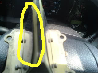

have you checked the reeds, gappy reeds will cause hard starting and flooding.
To check the reeds pull the reed block out and hold them up to light and look through the backside ... There should not be a gap for light to shine through... Here is what my reeds look like... And you can clearly see mine were bad without the light test.
