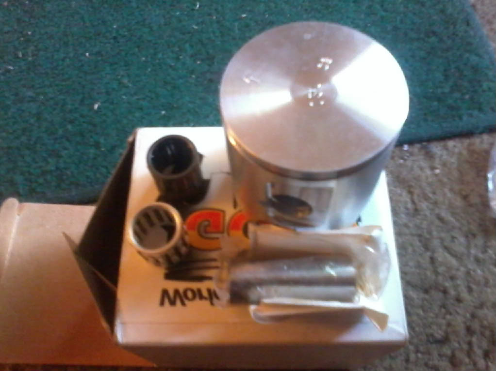

I got my piston yesterday and my grips.. but he sent the incorrect grips
