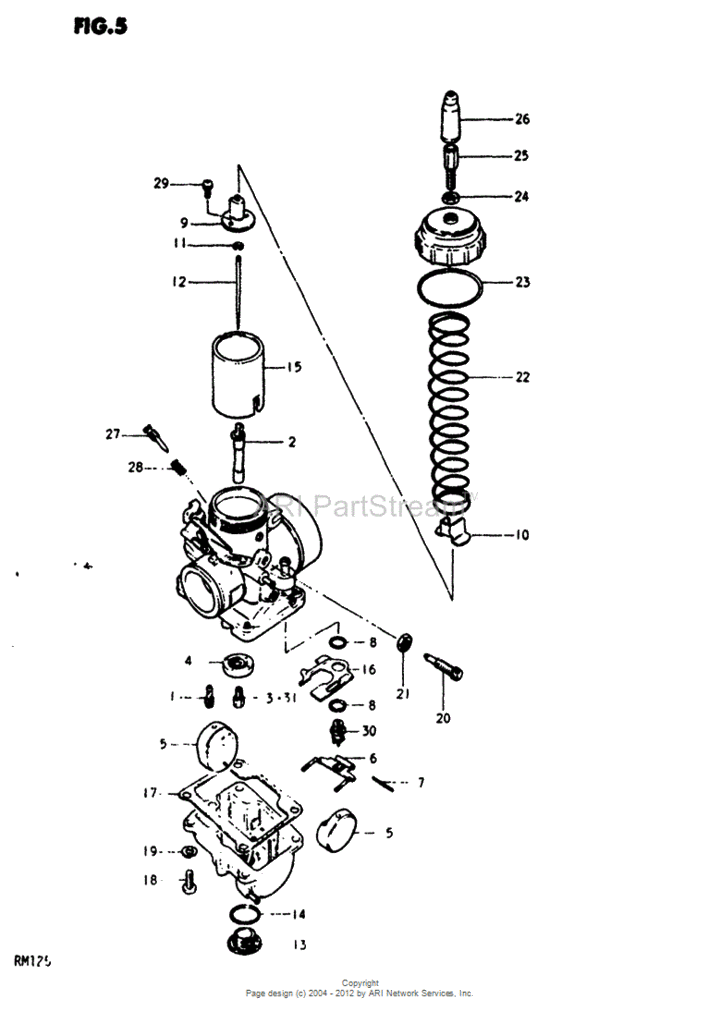

Hmmmm. Now the reeds I did not check. Is there a PDF file somewhere that you know of? So I can look up where they are so I can pull em out and check?
I have this explosion but I can't really tell where the reeds are
Haha...
On most bikes there is like a whole block that comes out.. And you hold them up to the light..and make sure light cannot shine through them.. Thats how you test them.
You can tell by looking at my old ones.. they are bad... But uoi can look through the back of the block (facing down there in the picture) ... And hold the front towards lights.. And if you can see light shinging through the back.. Your reeds are bad.
I know they're 2 different models but that looks nothing like what I've seen. Well my ride is a fossil :D. I'll take the Carb apart again tomorrow and snap a few pics for the thread. I sure hope the reeds aren't bad. I can't buy any parts for this thing. It'll have to be the whole Carb.
Nah... motosport has those reeds... I showed you the link... There not in the carb... They will be mount between the carb and the engine somewhere.... On motosport.com they are listed in the cylinder section.
