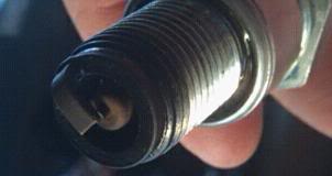

if your plug looks choco milk color you should be good... if its dark you go leaner, light go richer.. what are you mixing your gas at? I posted a thread names 'questions about jetting', James gave me a link to the best jetting and mixing info you could possibly read.. click on view all my topics, and read it :D

What you are looking for. (Look at the casing around center electrode.. You will need to get a flashlight and look down in there as far as you can.) You don't want it white.
If its whiter.. That means leaner.. (You dont want that.. Its fatal to the engine)
Blacker is richer..... (Its not bad on the engine.. Just a bit harder to start.. And lower on performance)
