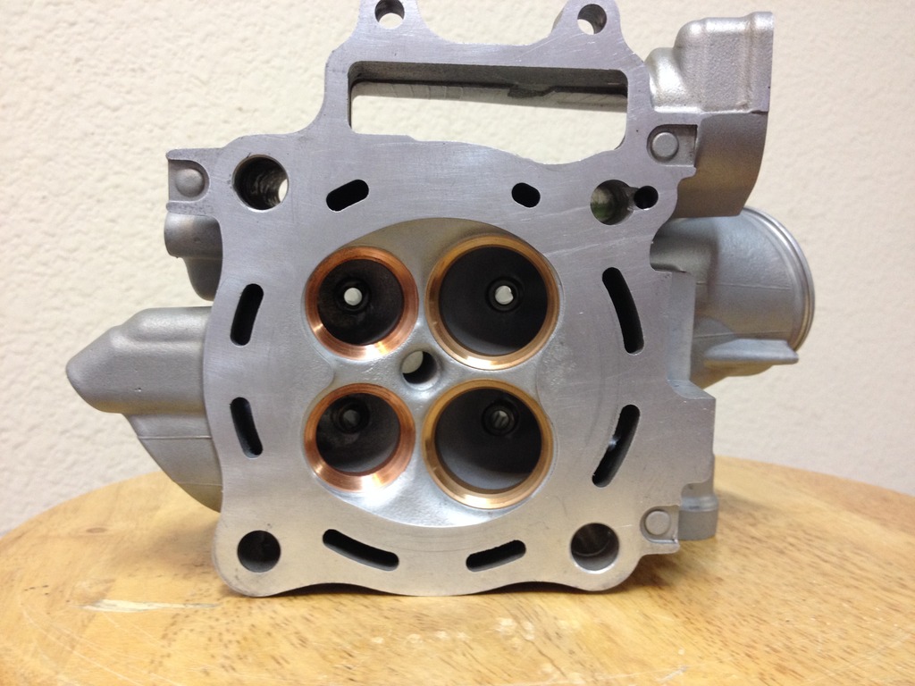

Got my head back! Time to get to work :)
Pro circuit did the seats. Just had em recut. It's me wFo ossa. Turns out somebody put the wrong collets and spring retainers in. Was a big clusterfK I think the Ti exh valves may be more trouble than they're worth well see. Gonna keep my eye on them.
yeah, i remember you WF. just wondering the head work looks pretty nice but it looked like more angles, but this screen came over with a guy named columbus. if your ex valves are stockers, they are stainless. the intakes are Ti in a stock engine.

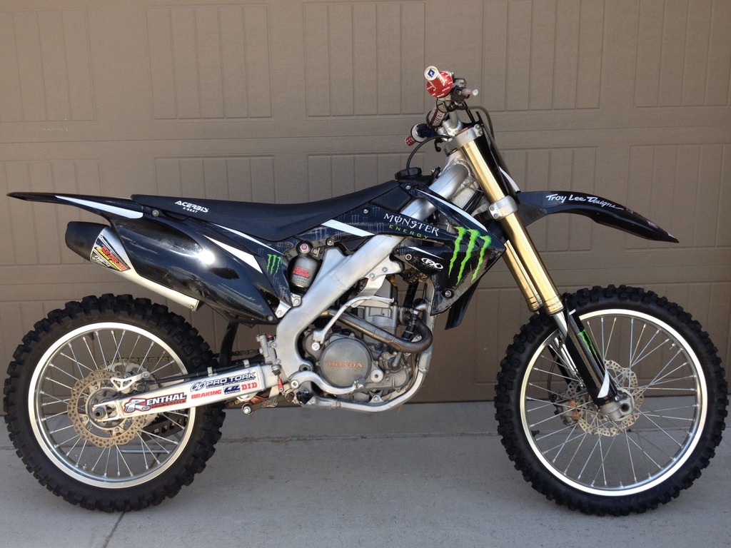

The only thing stock in this powerplant is the crank and rod. Hell its only money :) yah it's a '10 and not worth what I got in it but I got it to ride not sell. went with high comp PC piston & cam Ti exh valves etc. gonna pick up some 112 today and see how (if) she runs lol.
