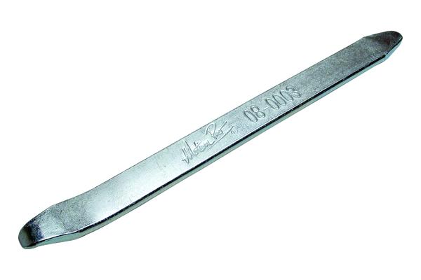

I carry the Motion Pro cold rolled steel ones. The are not too heavy and work fine for me. It just barely fits in my tool bag. I think it is the shorter 8 1/2 inch one, but it may be the 11 inch version.
