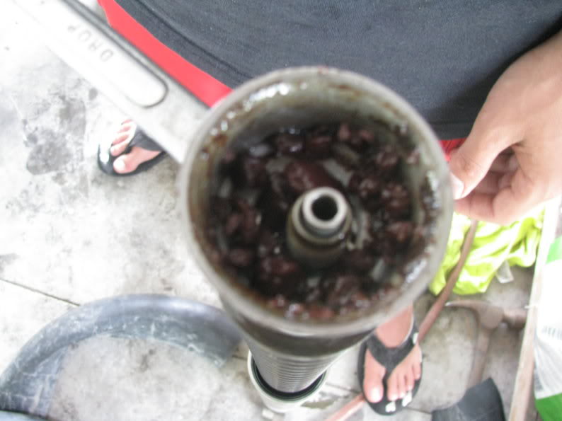

WOW! that is insane!i finally did it and it was nasty. it was really easy to do though.
here is a pic of the chunks of old oil i found inside
