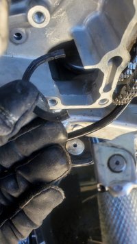

Because I just spent all this money to rebuild it and just felt "better safe than sorry" so I wanted to open it back up for a peace of mind.
Also found this piece of rubber inside here by the oil cleaner, only thing I can think of is a seal, right? So looking more like Ima need to just disassemble so I can find out what seal this is and replace it.

Yep, water gets everywhere. Not even something to consider after you have taken the head bolts loose.
Set the timing, put it back together and check the valve clearances.
Report back. -BIG DAN:thumb:

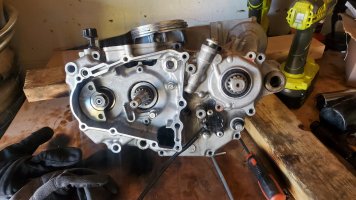

I found what looks to be a seal on this opening on left side of case. Wondering if its possible(can be done without destroying anything) to be able to leave clutch plate and gears all installed on ride side of case and separate case on this left side? This way I can save some time plus hoping seal is someone on left side of case since this where I found it. Lmk?

Whole bottom end was good. Cracked case open, sprayed compressed air to dry inside from anti freeze. Sprayed all the bearings good then hit em all with assembly lube, transmission and all other gears as well. Put bottom end back together.
