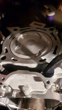

Because I just spent all this money to rebuild it and just felt "better safe than sorry" so I wanted to open it back up for a peace of mind.With only 2 - 3 hrs. run time ? I just don't understand ....

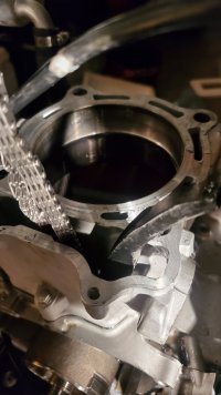

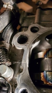

I found what looks to be a seal on this opening on left side of case. Wondering if its possible(can be done without destroying anything) to be able to leave clutch plate and gears all installed on ride side of case and separate case on this left side? This way I can save some time plus hoping seal is someone on left side of case since this where I found it. Lmk?Yep, water gets everywhere. Not even something to consider after you have taken the head bolts loose.
Set the timing, put it back together and check the valve clearances.
