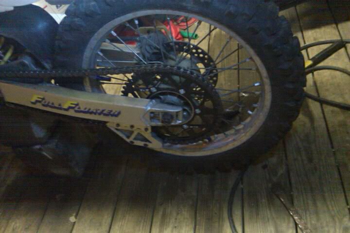

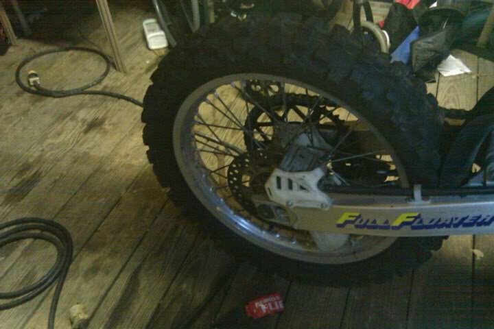

Drilled out all the sprocket bolts (PO stripped the nuts off) Put new sprocket and bolts in. Replaced rear bearings and seals.

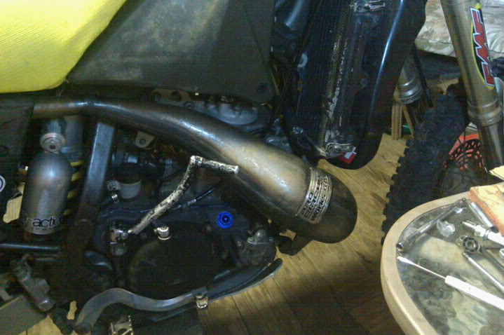

pulled off the old pipe and put the new Works pipe on
