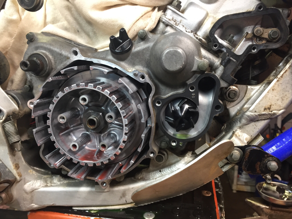

1) You will be removing both outer right covers.
2) It looks like it will slide right out without having to cut it off. If so, try and put a pipe that slides over it or a cresent (adjustable wrench) on it and and tweek it back the other way a little.
3) If you end up with a cut off wheel (and I don't think you will) just be patient to cut slowly.
Good luck, and cool wife and kids, I'm lucky when I get a gift at all. But, I really don't need anything anyway.

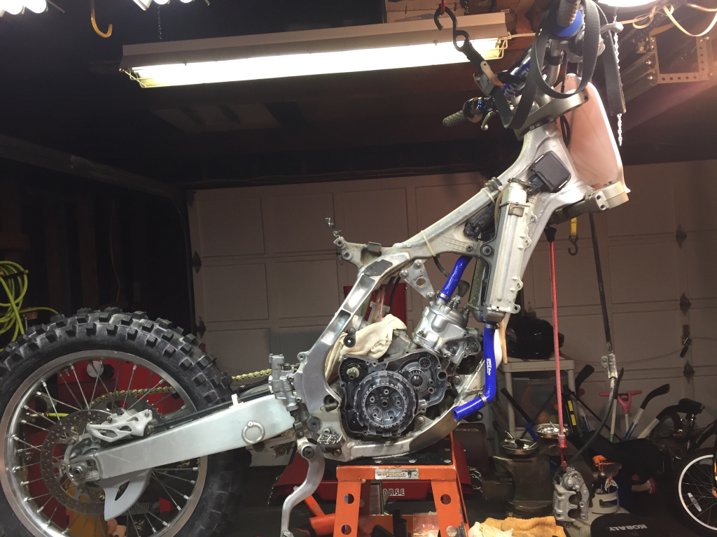

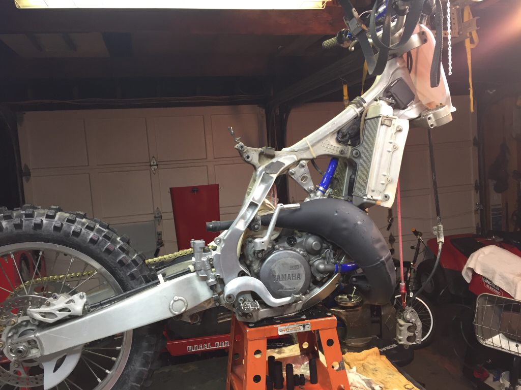

Hi Fellas... While I got the bike up here I'm thinking about doing the piston and ring kit. I've searched my manual for operating compression pressure and couldn't find anything. I read somewhere else that at 125 to 130 the piston should be replaced. What's a normal operating pressure?
Ok. Cool thanks. I'm going to order a kit anyway. I know at some point I'll be replacing it. Also ordering the shift shaft. I need things to keep me busy until the suspension comes back. I've been taking apart just about every moving chassis piece an re-lubing it. Also repacked the silencer.

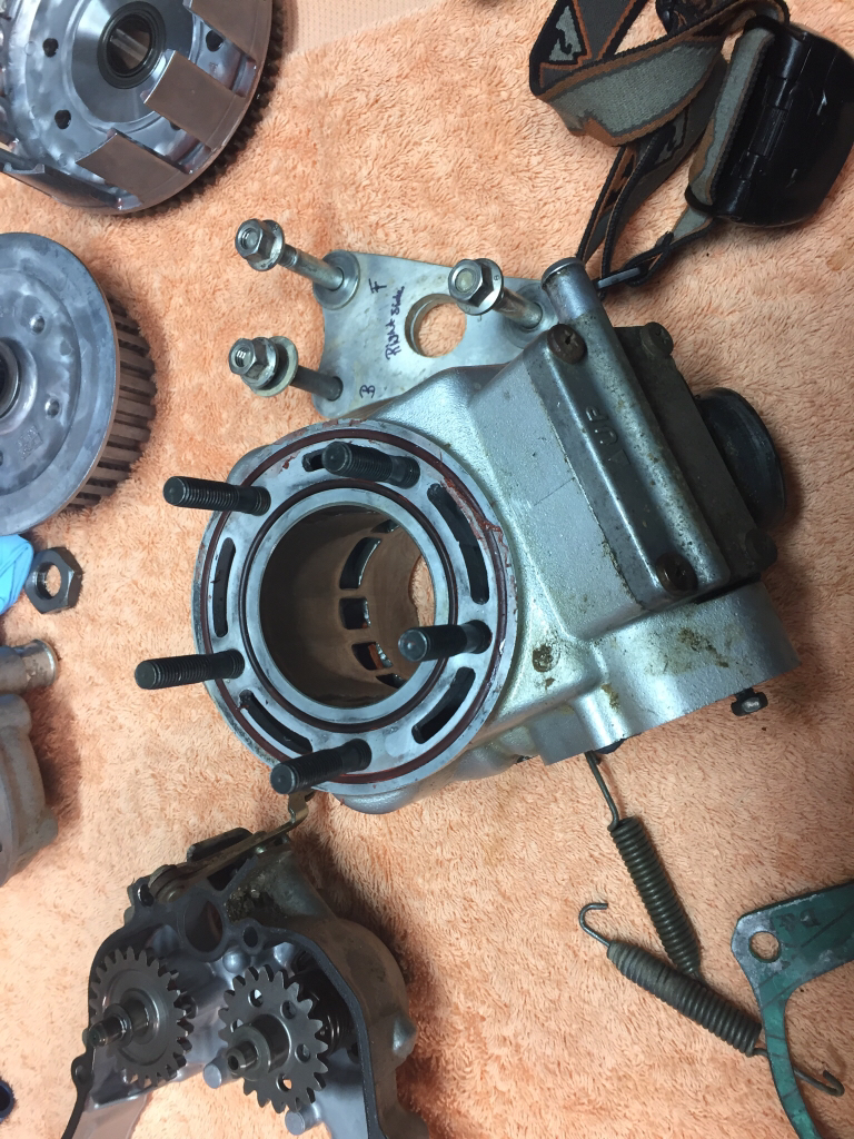

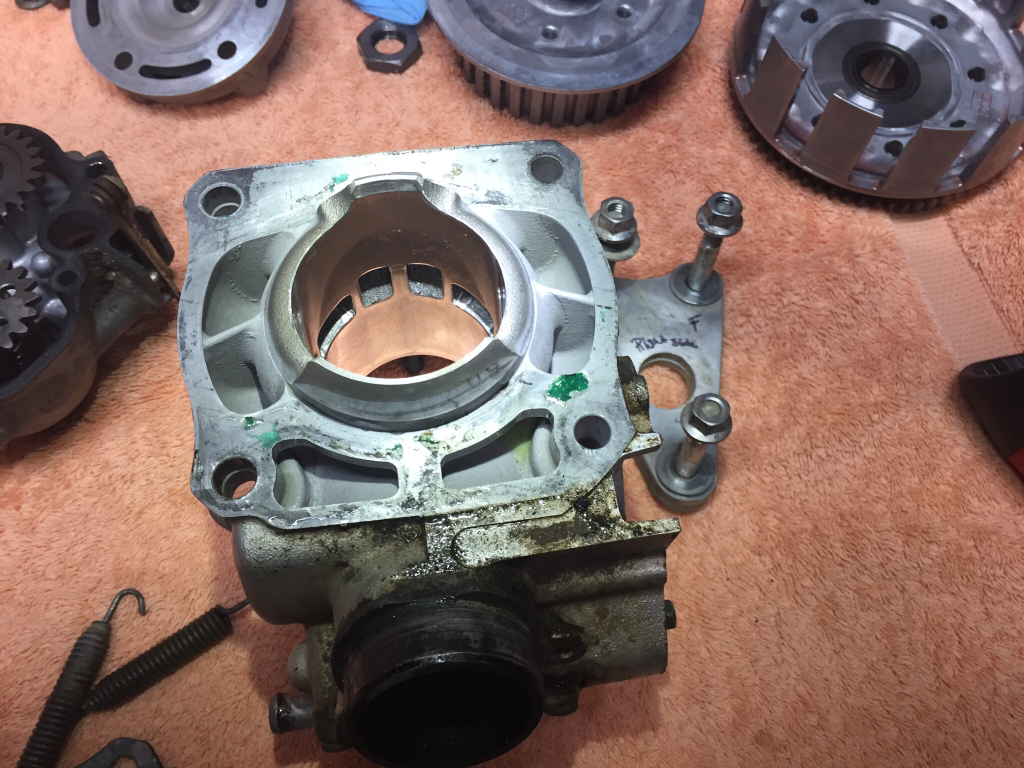

Measure bore before you order piston.

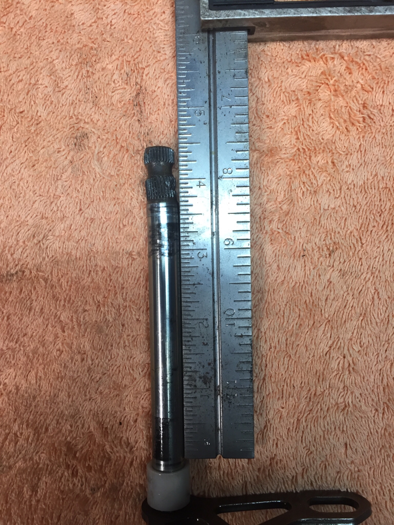

Ok. It's all apart and measured. Stock bore...[emoji1303]

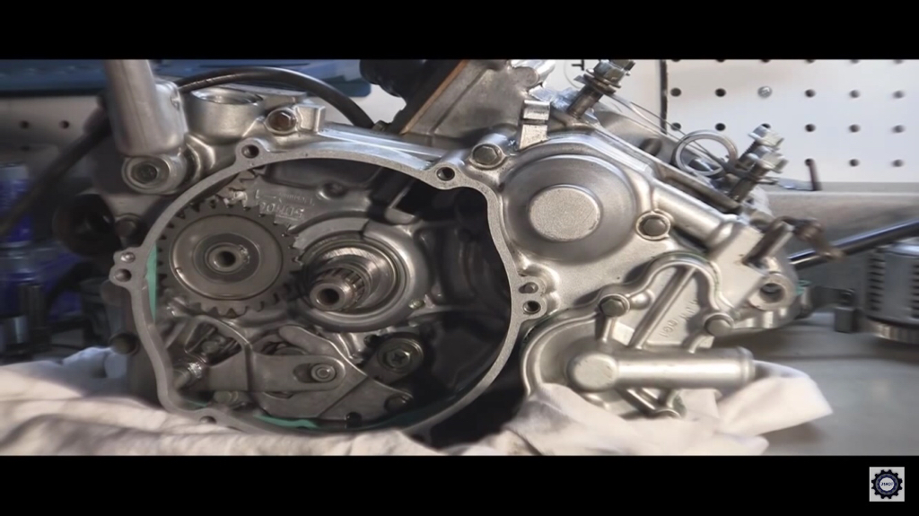

Here are some vids from tonight.
https://youtu.be/B7cLmTy-DZ0
https://youtu.be/mrSNnE-_QCc
https://youtu.be/gohNpcAol9E

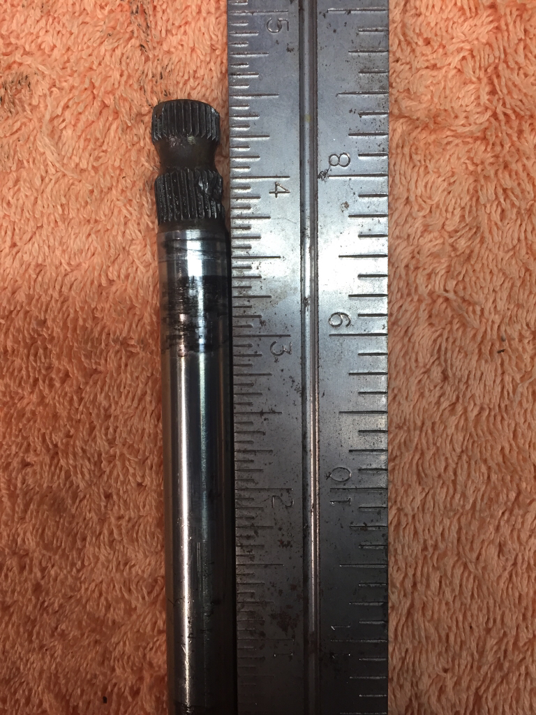

Here you can see the bend up against this straight edge. It was worse than this. This is after I straightened it a bit.

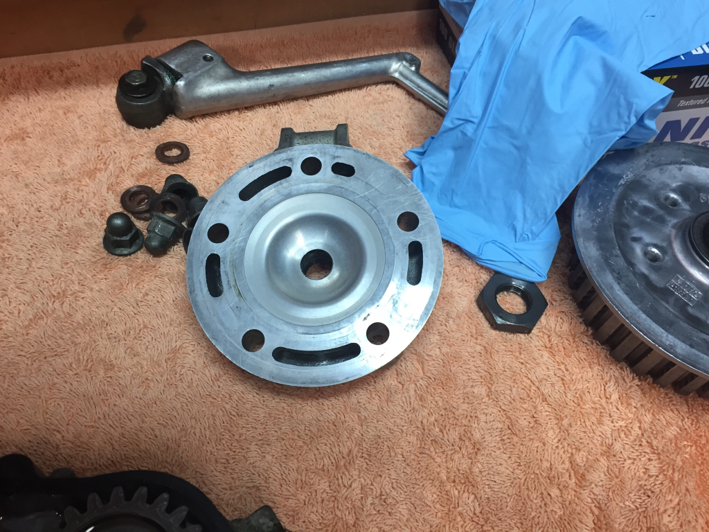

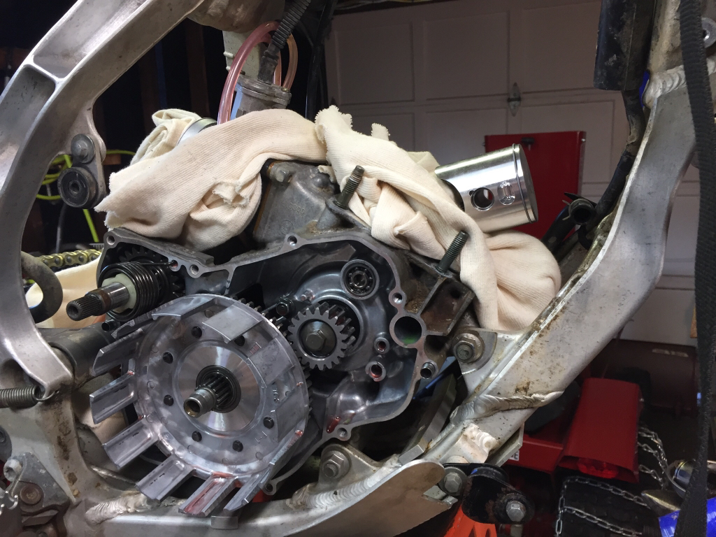

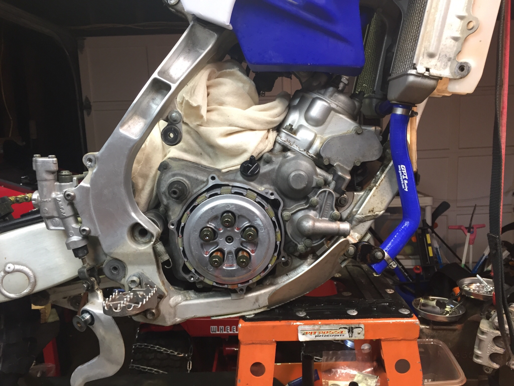

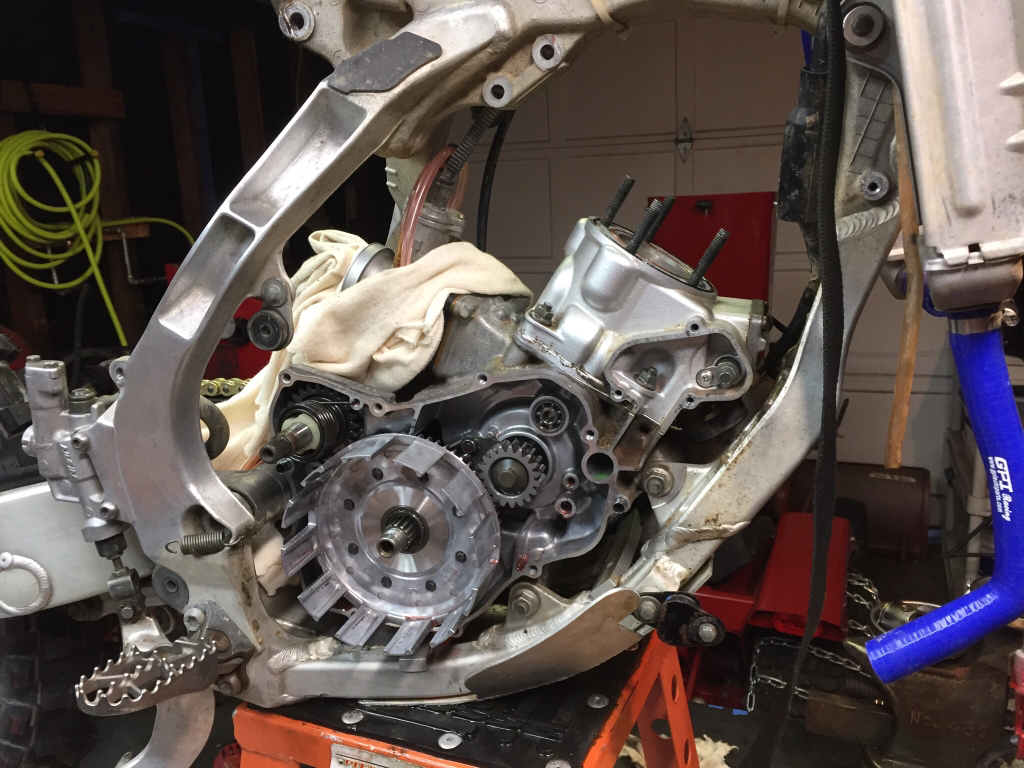

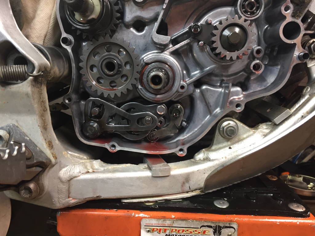

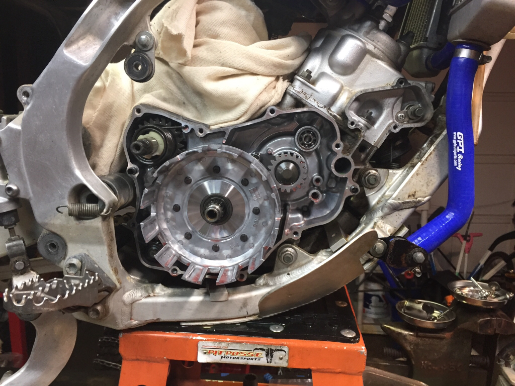

Tonight I put the new shift shaft and seal in. Also installed the new piston and buttoned up the cylinder and head. I have the fiber clutch plates soaking and I'll load those up tomorrow. Hoping to have this engine closed up tomorrow night. I talked to Jay at GRR today and he said I'll most likely be able to get the suspension Friday night! Might have this puppy completely back together over the weekend.
