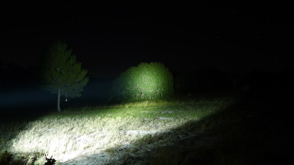

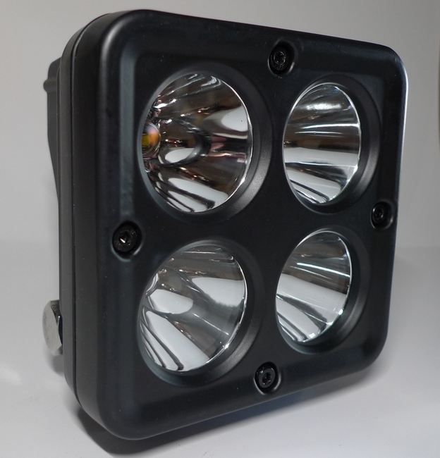

Not narrow enough? This is a $110 model(4 bulb 3600 lumens). Im getting the $70 half model of this. (2 bulb 1800 lumens)
The Tree is 250ft from the light

For trail riding that light is about perfect as far as I'm concerned. The price is good as well. They also give realistic lumen numbers that are likely close.
A guy I used to ride with had one of those BD 8 inch race lights with HID. He would average 70 on the smooth desert roads where I could only do about 50 because I just didn't have the light to see far enough. You really have to see what those race lights are like in person to understand. Same for that TrailTech SCMR16 HID. No reasonable LED that I have seen throws light like those. It's simple optics really. HID has a small very intense source. The XM-L is 2mm x 2mm and needs a larger optics to focus small. Most vehicle LED lights use smaller optics.
