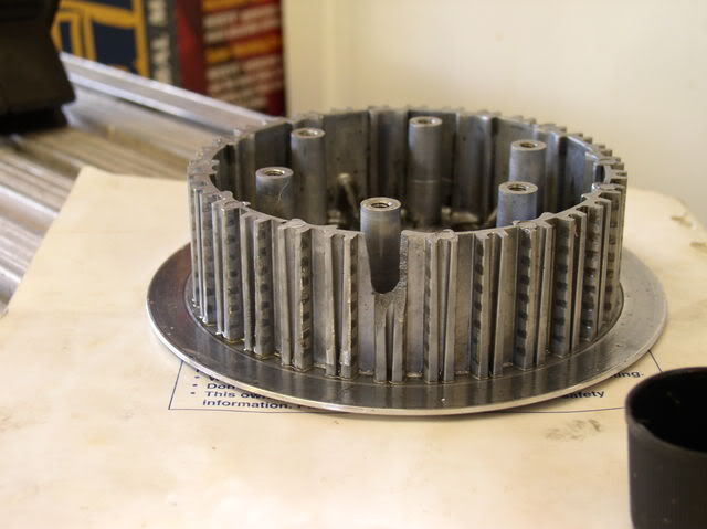

How do you pull the clutch? The clutch sits in the basket and the basket is held in by the main bolt in the center. When you try to remove the main bolt of course the basket spins. From the manual it said to hold the basket with a wrench then break the main bolt loose. I'm use to the big bikes were you pull the small bolts and everything just slides out and the big bolt just holds the basket on.
Bolt #22 is the one I couldn't get undone so that I could get part #6 off. I ended up breaking part #3 trying to use the little fingers to hold the basket in place.
Oh, I was confused, I thought the basket is what you were having issues with, it is the clutch pressure plate you are having a haard time with. I never had any issue removing them either. I used a 18v battery impact and they came right off. I used a washer behind the basket wedged in between the gear on the back of the basket and the primary gear to break the basket bolt loose.
Oh, I see it says it requires loctite. Any bolt that has Loctite on it needs to be heated to melt the loctite from previous install. Then it should break loose.
I think the lock tite is what is killing me. Soon as I get the clutch tool I will heat it and hit it with an impact.
Just wanted you guys to know the Tusk Clutch tool won't work on the KTM65 the little stubs are too big to fit in the holes. :foul: I'm going to try and hold it and just hit it with an impact gun if it won't come undone I will take it to KTM and have them buzz it off for me. Wish my parts would get here!:thinking:
