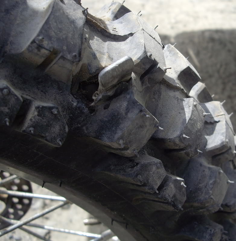

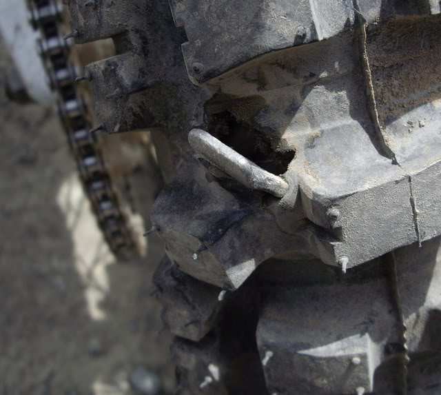

That was a bad ass tube you took out of there.
on 1) Me too...no bad experiences
on 2) I say, just cotterize the ends shut and re-use it...:smirk: Puttin it back in shoud be easier, a little more flexible...:smirk: ..:P
