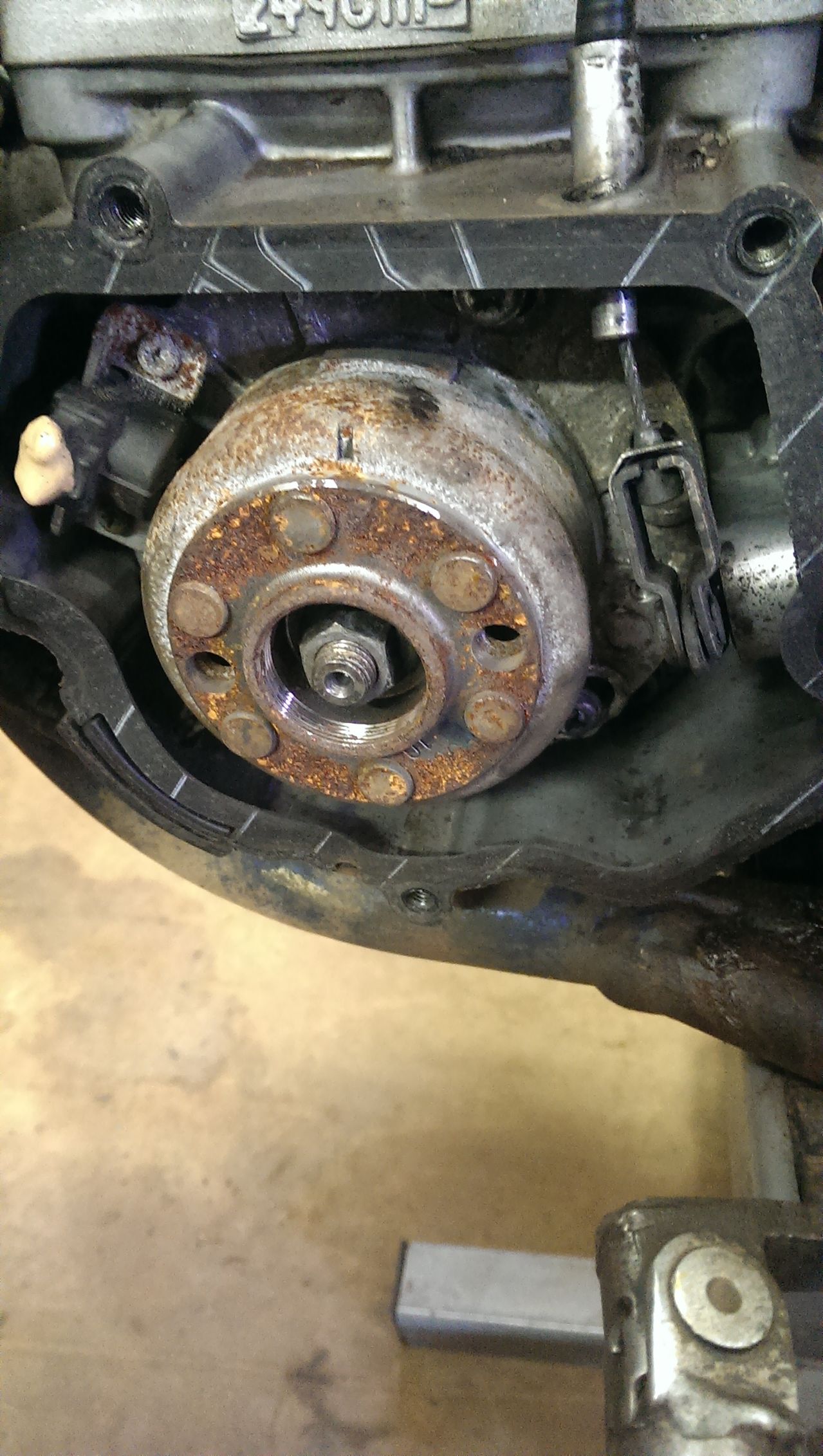

Will do. I looked at stator just with the left side cover off and the stator looks kinda rusted but if i pull it off do i gotta worry about any wires or parts shooting off or anything?
Nah. You should be good. Clean upe the stater a little bit and see what happens.
Just a thought, shavings on the crank positioning sensor will cause it to not fire as its not getting the signal to fire the spark plug, Learned that recently with my bike. :banghead:
