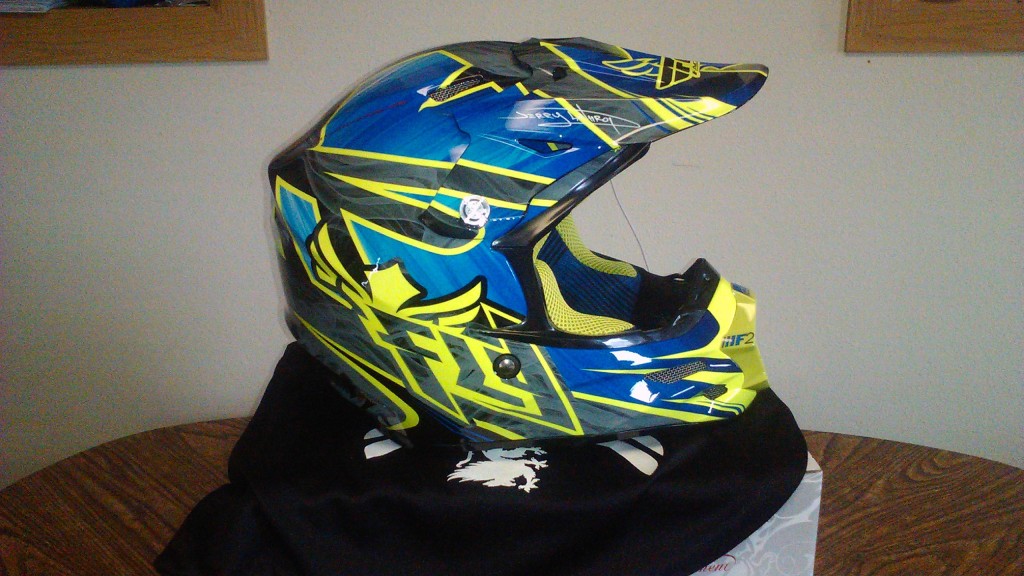

I know carbon fiber is super strong when it comes to tensile strength, but for some reason I dont trust it as a helmet material. Maybe its because I see those race cars exploding upon impact. Then again im not hitting the ground at over 200 miles an hour. My question, what do you think about these helmets? I bought a fly carbon 2 without knowing it was carbon until I got it today. Dont ask :smirk:. It fits pretty good, and its really light. Being so light it makes it seem cheap, but it doesnt flex like like a plastic or fiber glass helmet. Someone talk me into this helmet so I can trust it a little more. Thanks :thumb:
Heres the pic
I did not see where or even if you posted. How much did you pay for the helmet? You do not have to tell us if you do not want to. But, I bet it was around the price of a new 6D helmet. Like I said you do not have to tell us.
