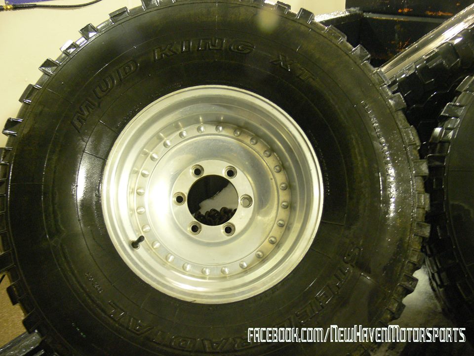

Found these on craigslist for 200 .... 2 hours away... I got them for 125.... And they are sweet. I love them.
