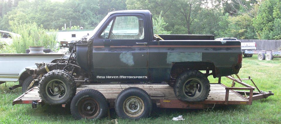

I had bought a 84 2wd for parts... And ended up selling some parts and the bed/tailgate and bumper.... And then i found a guy wanting a 2wd project... But he wanted a complete running truck. Wanting to trade it for a running 4wd k5 blazer... We struck up a deal, That i would get the truck running and driving and looking decent. And he wouldn't have to mess with the K5 as i was going to be stripping it comepletly down anways.....
So i had to buy a bed and parts to make the truck decent again..lol

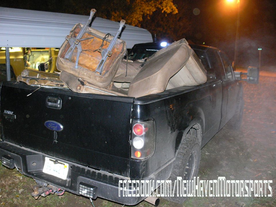

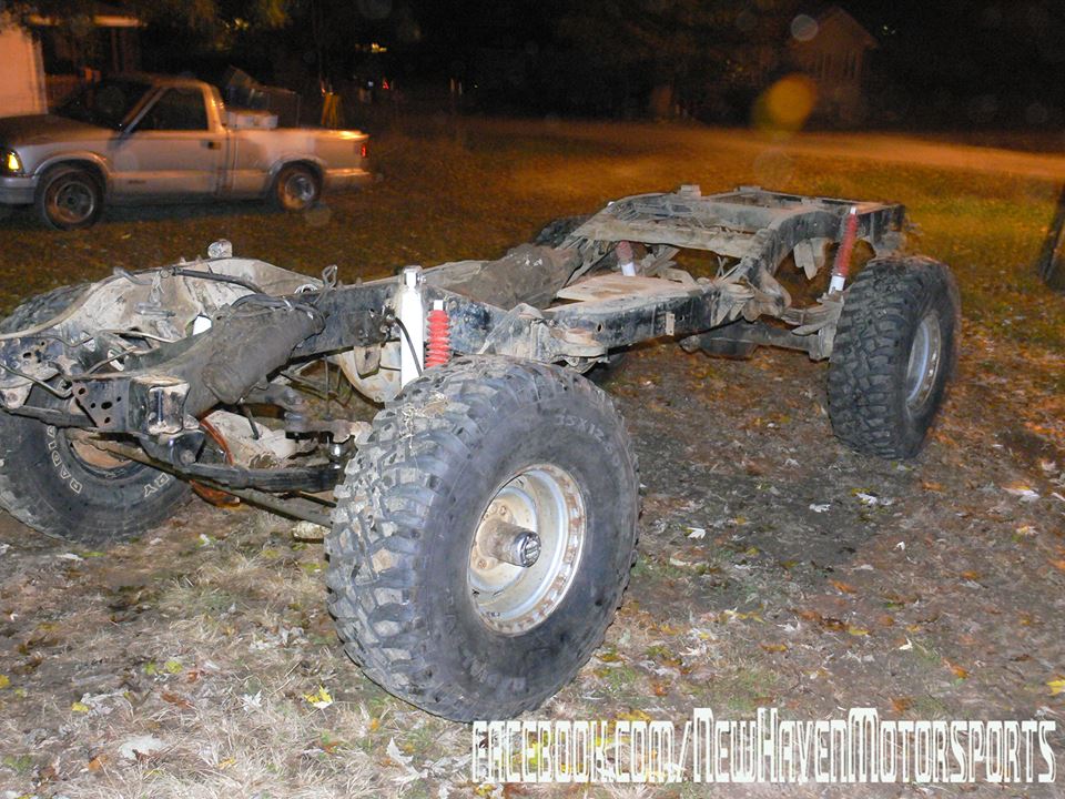

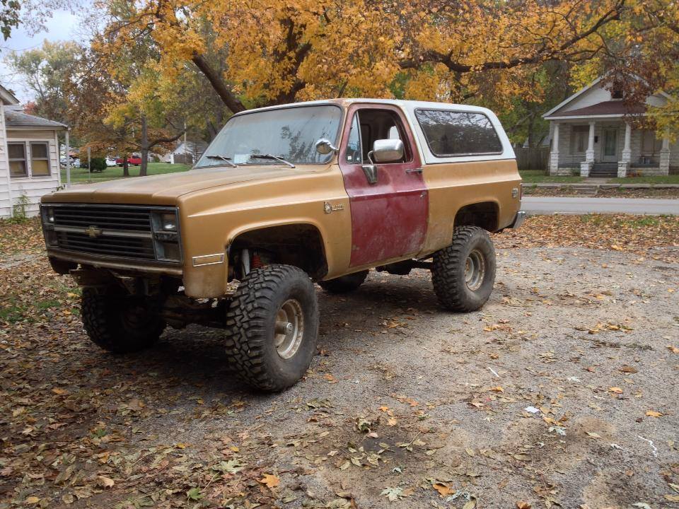

Picked up this well beaten 84 K5 blazer, a November 2, In Central Il
You like that? :lol:
Still November 2, lol.....That is where we quit... Sprayed the frame down with mean green and let it sit over night. In the morning we pressure washed it. This is all after we spent like 30 dollars at the dang carwash on the way home lol... It was packed full of mud.

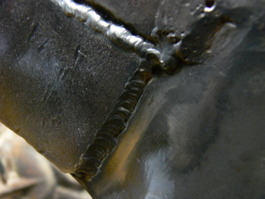

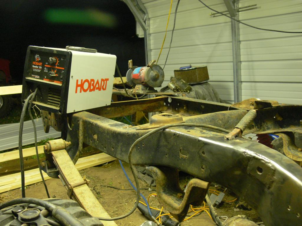

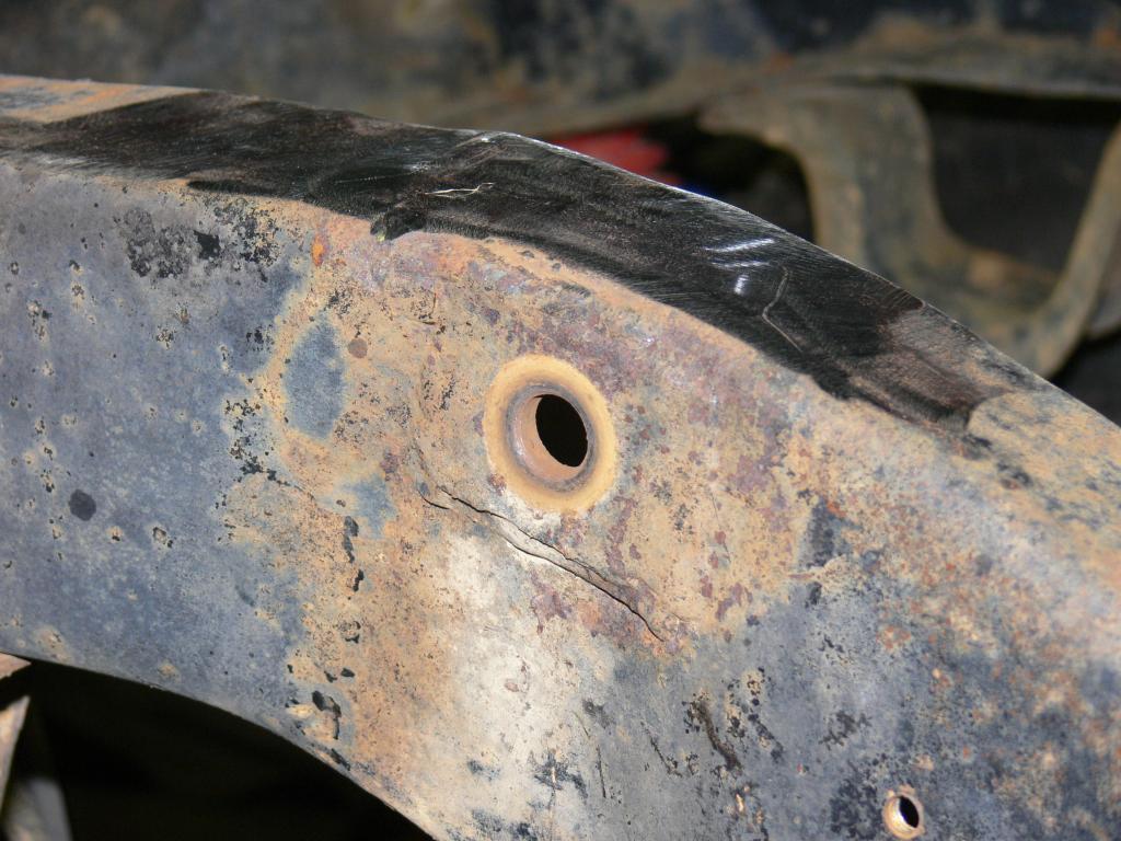

November 11... After we cleaned the frame up some.. Got it back in the tarp shante building/garage.. Noticed the frame was pretty jank...Someone had weldeerated a patch on it.
You wish you had a grinder bench like that, ehh?
Welded in a patch under previous owners patch... Also on the back side.. It was really nasty looking back there... We ground out most of that.

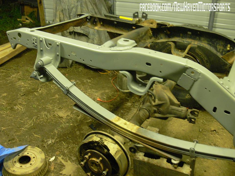

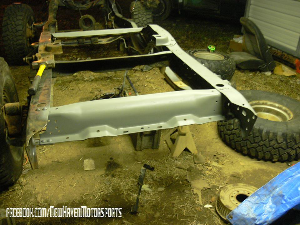

November 17,started to primer the frame and what not.

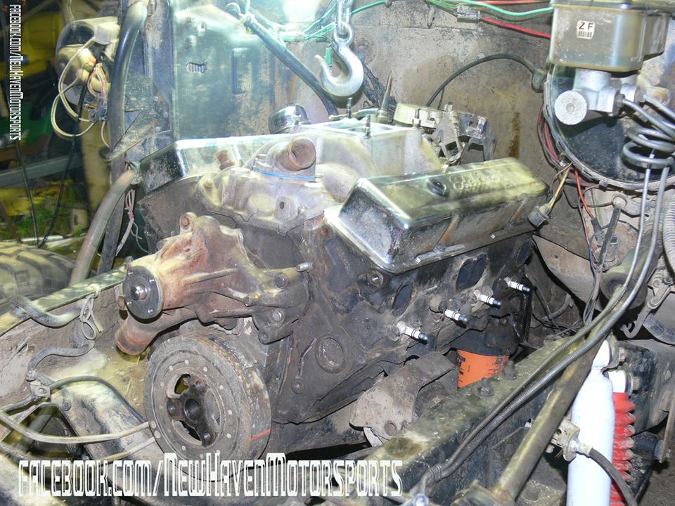

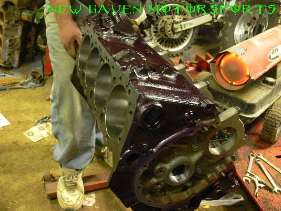

Nov 22, FINALLY picked up my block from the machine shop. 400 .040 over.. 408ish cube. Hate on that paint!

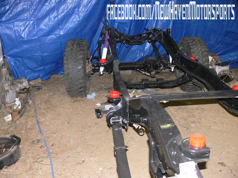

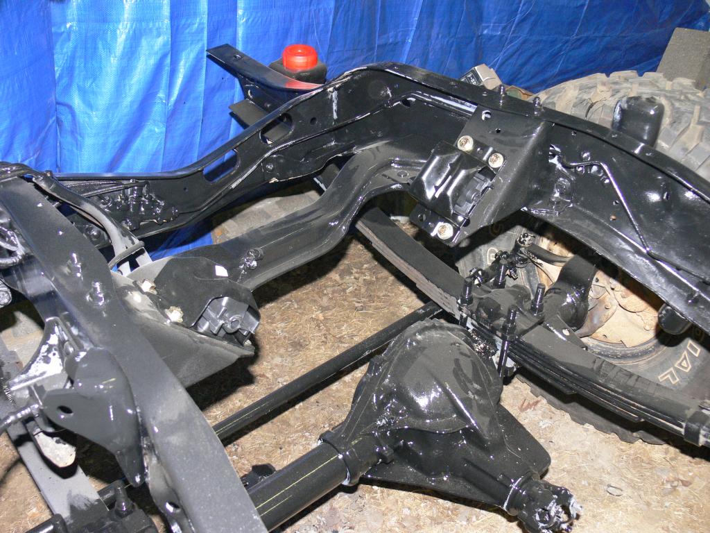

Frame is painted... Painted with a brush. Wanted it thick, And it turned out amazing.

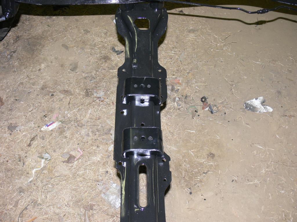

Nov 28... Got the front shocks mounted in there new position,New motor and tcase mounts on.

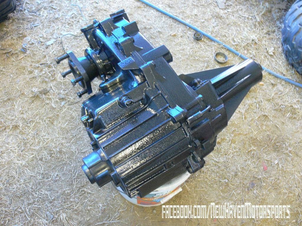

208 tcase, Painted hammered black... Makes it go phaster right?

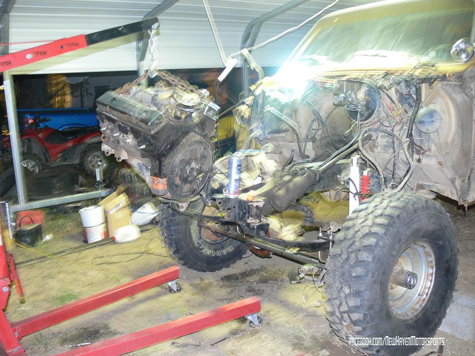

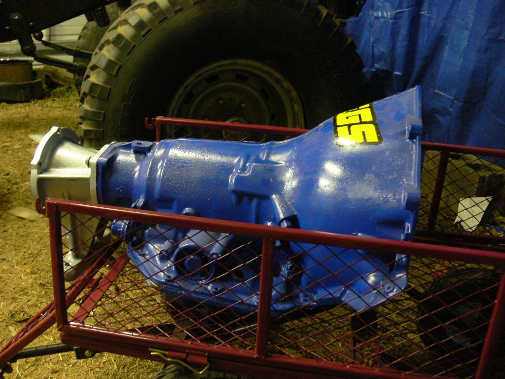

TH350 with the B&M goodies. Painted some kind of blue.. Prolly ford blue :wink:..shh... Tcase adapter is Silver and sprinkled fairy dust on it to make it have more HORSEYpower, (HAAAYYY)
December 1, Put that bish in!

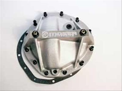

Got my rear gears and bearing kit in... Still waiting on crush sleeve elimination kit and front gears.

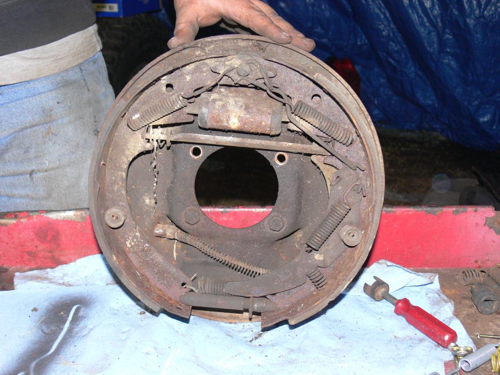

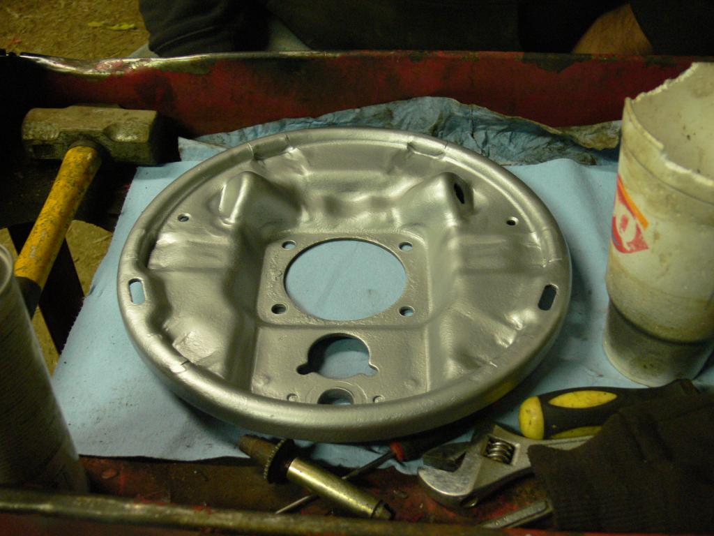

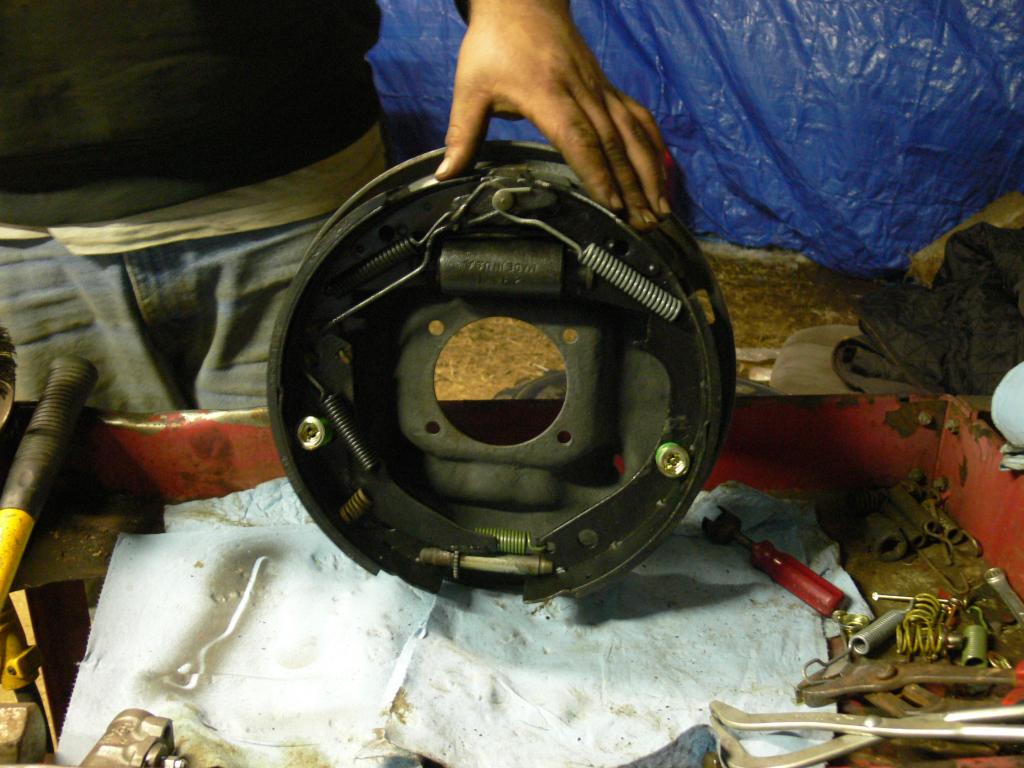

Finished up the rear brakes. Cleaned,deleted emergency mechanism and installed new parts. Painted everything also.
Also cleaned the rear end,rear drive shaft,tcase linkage and painted it.

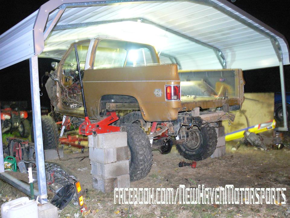

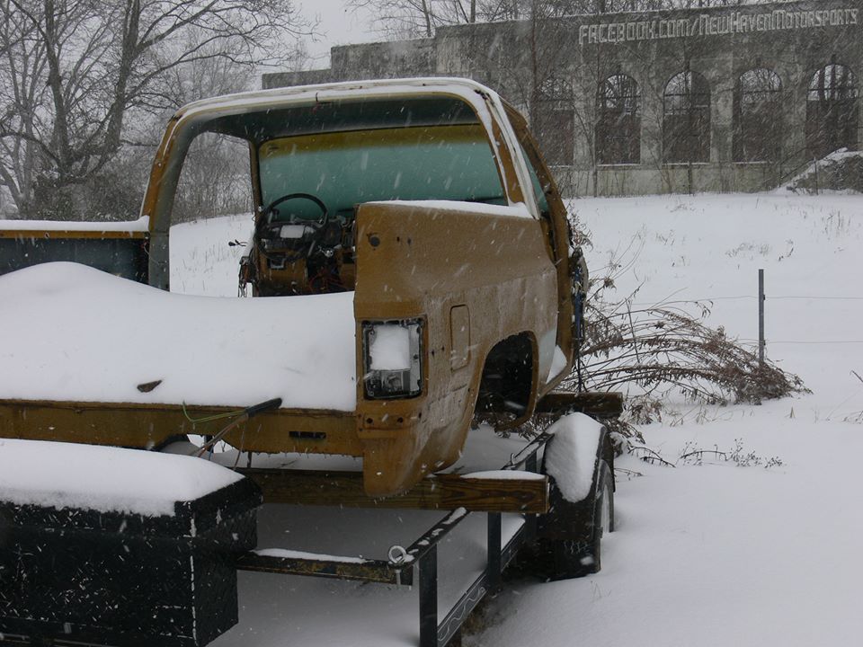

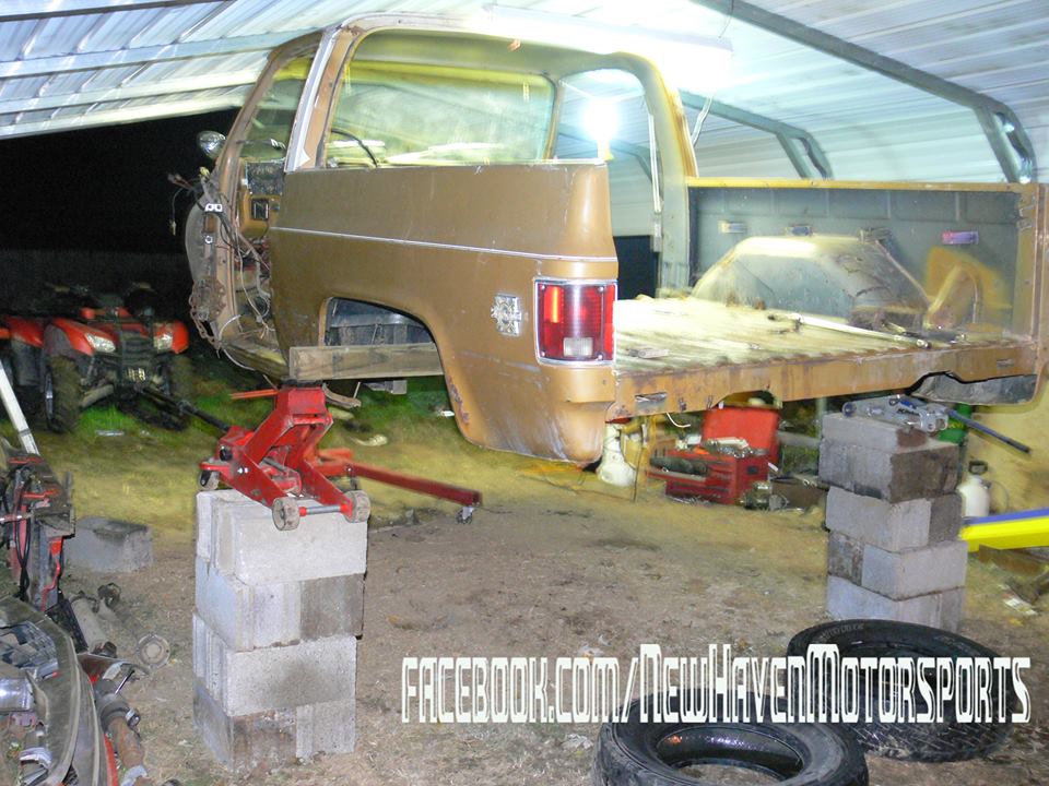

Body is sitting in the weather, Till the frame is done :(
Its going to be a mud race truck...Dirt race truck basically. Most tracks around here are moist dirt drag racing... We do some traveling and get some other types of tracks.

Need to get frame and axles done so i can roll it out and get the body in the building. Frame is done,Besides some fabrication to mount the rear shocks in the new location. Waiting on parts to come in for the rear axle. And havn't started on the front axle yet. But its pretty well painted.

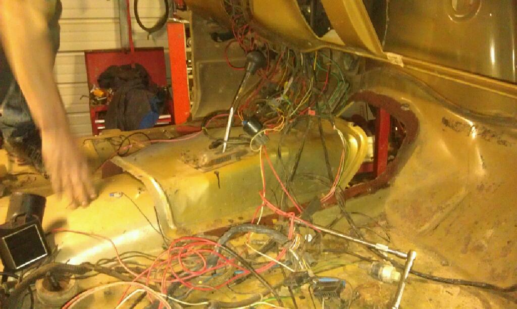

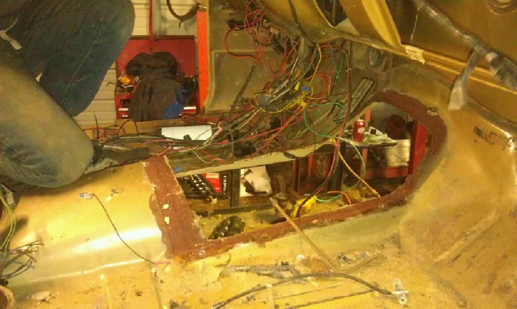

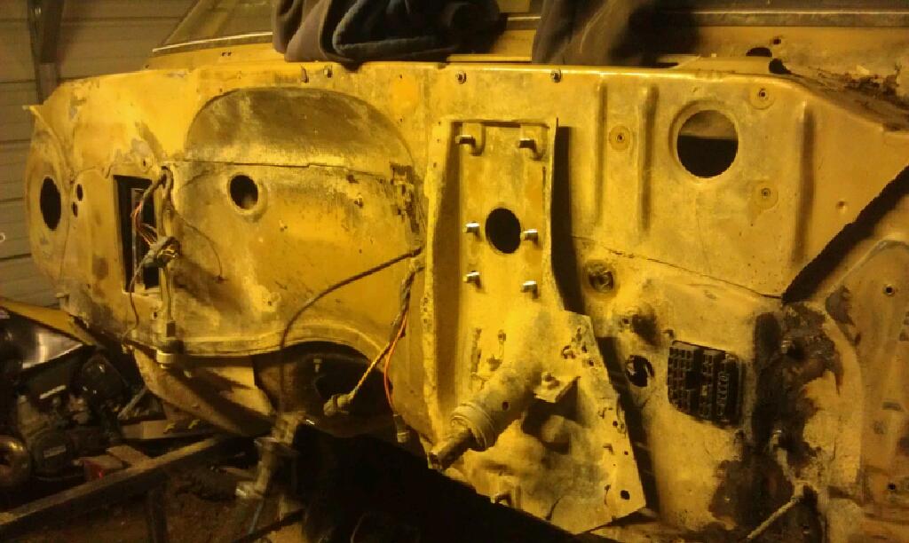

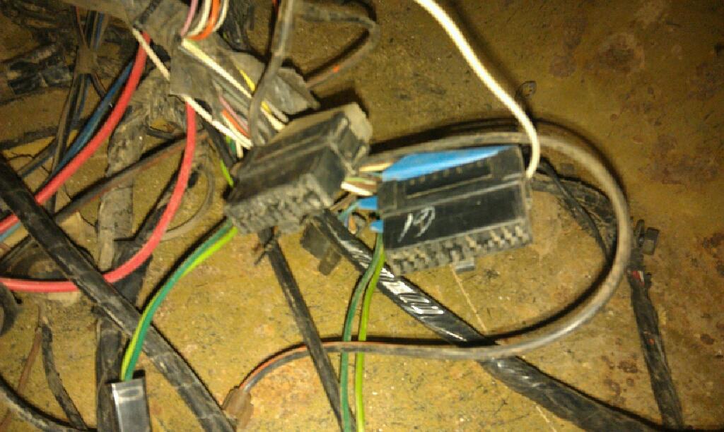

Now we get into the real mess.... This is the crap i hate right here.Hated it so bad, I took these pictures with a toaster.
I think Ray Charles wired this thing. Its supposed to be an 84, but its go all the wiring for TBI...
I will get some better pictures. My buddys were sanding, and i didn't want to take my good camera in that mess.
Basically lol/..

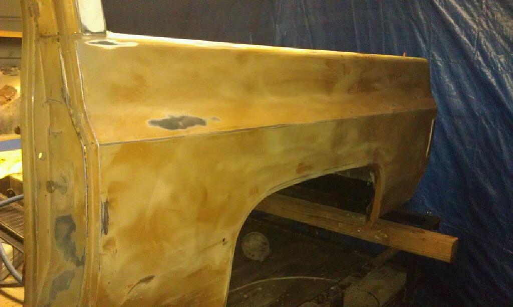

Finally took the body to the car wash, It was solid mud basically.
Some idiot decided it was cool to install those police spot lights. WITH A TORCH ..... :suicide:.... Both sides..
Before the liner

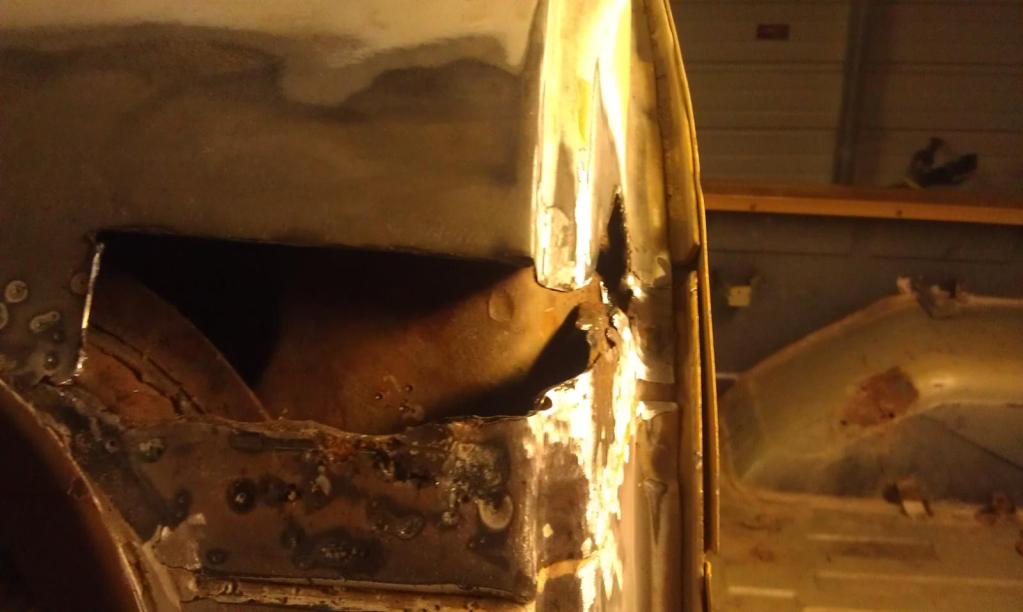

Worst rust on the whole thing... Most is fixed now... The one floor pan has yet to be fixed, will be working on it after the body is on the frame.
Most of the underside rust holes are fixed. All bottom side of body is wire wheeled,prepped,primered, and coated with bed liner.
