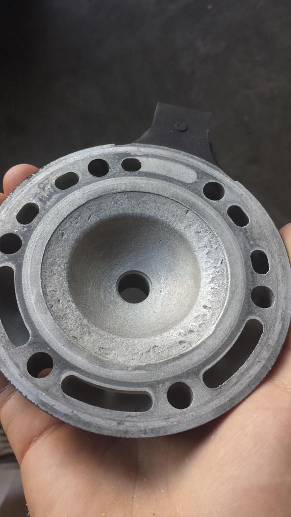

On my head it looks like a plug electrode must have broken off or something. It's a little rough but I wet sanded it with 400 grit to get rid of any burs or sharp edges. What do you all think about its condition?

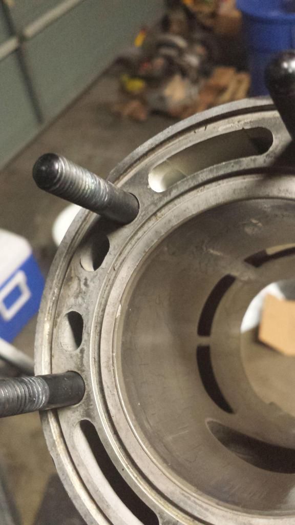

The nikasil on my cylinder looks good, I'm going to hit it with a dingle ball hone to mate it with new rings. That's OK right? I only found a little imperfection in the nikasil, I'll post a photo I figure it's fine though.
Nikasil photo:
http://i1375.photobucket.com/albums/ag471/JakeBoucher/Mobile Uploads/1404887877888_zps459c806f.jpg
Head Photos:
http://i1375.photobucket.com/albums/ag471/JakeBoucher/Mobile Uploads/20140708_174208_zpse53da546.jpg
http://i1375.photobucket.com/albums/ag471/JakeBoucher/Mobile Uploads/20140708_174158_zps041ec186.jpg
This is before resurfacing and sanding. Still looks much the same just no rough edges or burrs.
Nikasil photo:
Head Photos:
Nikasil plated cylinders are to hard to be honed by anything but a diamond hone if you use a stone type hone, it may deglaze cylinder, but it won't remove any scratches or imperfections, it may however, remove some of the plating around the ports if the stone catches it just wrong, I recommend using sand cloth or a scotch brite pad and oil to deglaze cylinder.
Thanks bobkyle!
Crap. So I can use scotchbrite and oil to do it? Would getting a Diamond hone be the better route?
I think youll be ok, you can typically get 2 or 3 rebuilds outa one of those before it needs replating. As long as cylinder doesn't have any nicks or gouges.
It has a small scratch but I think it should be OK after honing. How much does replating cost? I know the bike has been rebuilt at least 1 time, I'm not sure how many total though.

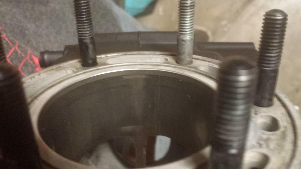

More parts showed up today, still no crank. Got all my seals installed today. Used OEM on the crank seals. I also put my transmission in today. Got it to shift through all gears the first time. It took me close to 2 hours to analyze it and understand how it works, then go through every part and put it all in in order. I Used some scotchbrite and oil to deglaze my cylinder. There is some discoloration on the wall, I don't know if it is normal or not. I'll post a picture and get everyone's expertise. I have a big ole mess to clean up tomorrow!

Cylinder:
http://i1375.photobucket.com/albums/ag471/JakeBoucher/Mobile Uploads/20140709_213030_zps0bd40d4a.jpg

Cylinder:
Hard to tell on my phone but it looks like you might need a replate on that cylinder.
Not what I wanted to hear lol. I think ill have it looked at by someone to be sure. Where is the best place to get it plated? I figure I have to ship it off somewhere. Thanks Mihylo
