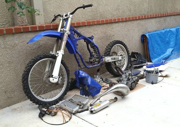

Something is wrong here?
Great time to load up another roller, half a dozen riders and head for a place to "downhill". You have a round robin match race series. We tried it with more than two and it just didn't hold interest as long.
