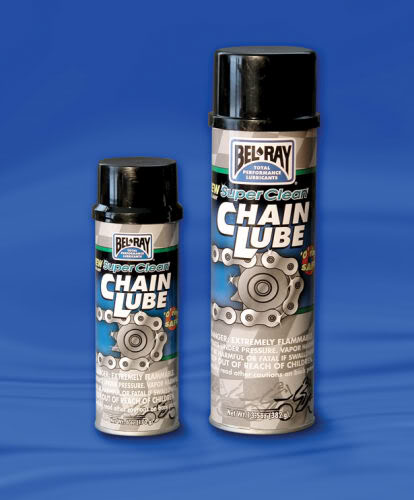

I've also tried Bel Ray's chain lube but that stuff goes on way to thick and ends up being flung everywhere.
I like the Bel Ray Super Clean. If it does sling off, my bike seams cleaner now, then with other lubes I've used.

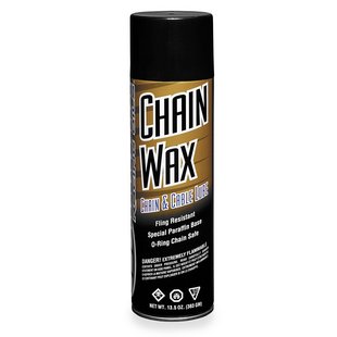

I haven't tried it yet, but a lot of people have been telling me to use Maxima Chain Wax:
thats what i got but i have never used anything else as i just got my first bike not long ago so i cant compare for you.
i am not sure if this is normal for all chain lube but it says to ride the bike for 5 mins before applying. I dont think i ever have warmed up my chain before putting it on.
I use the Chain Wax too.. I like it ! No mess. I have over 1200 miles on my bike and the chain and sprockets still look fine.
I never warm up the chain before application..:noidea:
Yeah I've never heard of warming your chain, maybe it's so it sticks better :noidea:
