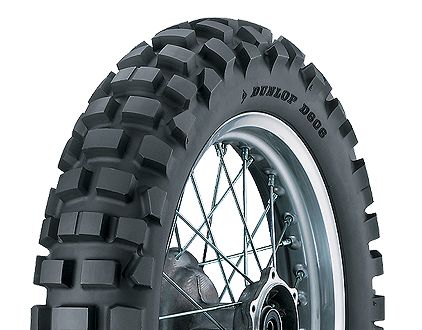

This Dunlop 606 is a DOT tire and look damn aggressive enough for dirt/sand.
But you can still see a rounded contour of the tread for carving some asphalt.
They offer up to a 130/90 which is pretty freakin wide!
-BIG DAN:thumb:

The D606 will work, but it might not be the best depending on your riding percentages between street and dirt.

Two sets can be pricy but if you can afford it, best option! Mud and sand the D606 if you have to be DOT on the rear is a long lasting tire. I run Trials because the sand is not a big issue but mud sucks bad. Get about 1400 + miles on the Trials and the D606 will give you a little more and they work well. If you don't need DOT, the options are endless and you can buy any inexpensive tire a run like hell. If you do go two sets, I ran Bat-16 on my Sumo 17" F/R and loved that tire in all conditions.
