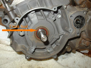

Crank seals?
There is a rubber seal between the cases and the crankshaft. It keeps air out just like the gaskets do. When you fork seals fail they let the oil out. when a crank seal fails it lets air in. Normally they are easily replaceable.
Here is a pic
My book says the reeds should not exceed the service limit of .2mm. So if there is a service limit, then wouldn't there be some kind of gap allowed? If they are cracked or chipped now that is different. If they were leaking air it would do it constantly as would the crank seal on the stator side. They clutch side would cause a oil leak and would lead to excessive spooge and loss of clutch oil. I believe NH nailed it with the cylinder base gasket leak.
