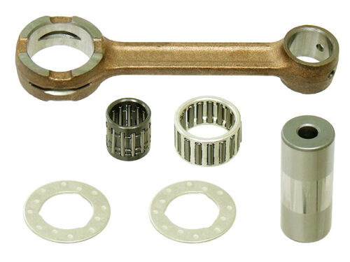

So what oil should I use for the cylinder and needle bearing? The 2 stroke oil, transmission oil or the assembly oil? Bike is almost done. Picking up the cylinder today and that’s the last piece. If one of the crank seals was leaking how would I know?

I use 2T oil for everything in the crankcase because that's what will lubricate later in life. Same for the transmission, it is assembled with trans fluid.

You ask about cylinder lube, and I prefer nearly dry or even dry to lubed. At the urging of a friend of mine who has built multiple national winning motorcycles, I do my final clean with atf and then rub the cylinder with cloth or paper towels until it comes up clean and is as dry as the towel will leave it. I wet the bearings all the way around, dump a bit (1/2 oz to 1 oz) into the crankcase, lay the bike over on one side for about 5 mins, then flip it over. that lubes the mains.

I’ve assembled all my motors with a light coating of atf. Stuff works great as an assembly lube.
