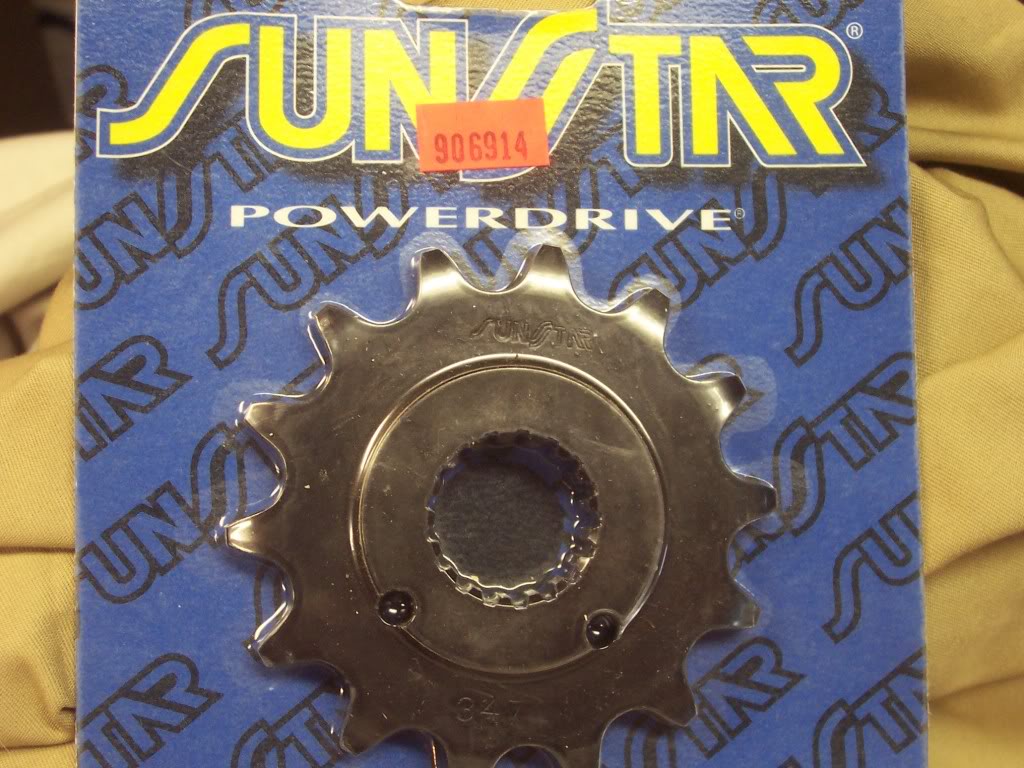

And CS sprockets are also loads cheaper, and easier to replace...Not to mention mine is looking like it needs replacing some time because the teeth, while still sharp, are pretty warped![]()
It sounds like it needs replacing now. The teeth of a new sprocket are not sharp. They get sharp as the sprocket wears. This is what it looks like when new:
