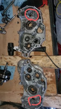

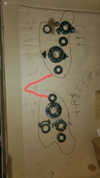

Doing a complete rebuild. I have everything on its way besides these bearings.

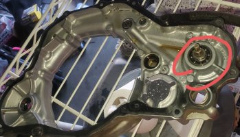

I have checked manual but it just refers to them as "bearing". Havent found any information breaking down name of each bearing. I know the big middle one is main bearing(crankshaft), which came with my rebuild kit. The outer 3 are for the transmission, I got those 6 in a transmission kit. The one in second picture I think is water pump bearing(can someone confirm please)
The 2 inner ones in 1st picture(on the cardboard box) I need name of? Want to replace them as well.

Counterbalance shaft bearings? IF they go forward of the mains.
93304-20310-00
-BIG DAN:thumb:
Yes, they are forward of mains. Thank you.
Maybe I misheard a video but for some reason thought one of the transmission bearings where the counter shaft bearings.
Appreciate it tho, you are always helping me, lol. I was scrolling down some of my old threads, you helped me with valve adjustments and understanding how shims calculation, ect, is done.
Appreciate all the help. Have a good day!
