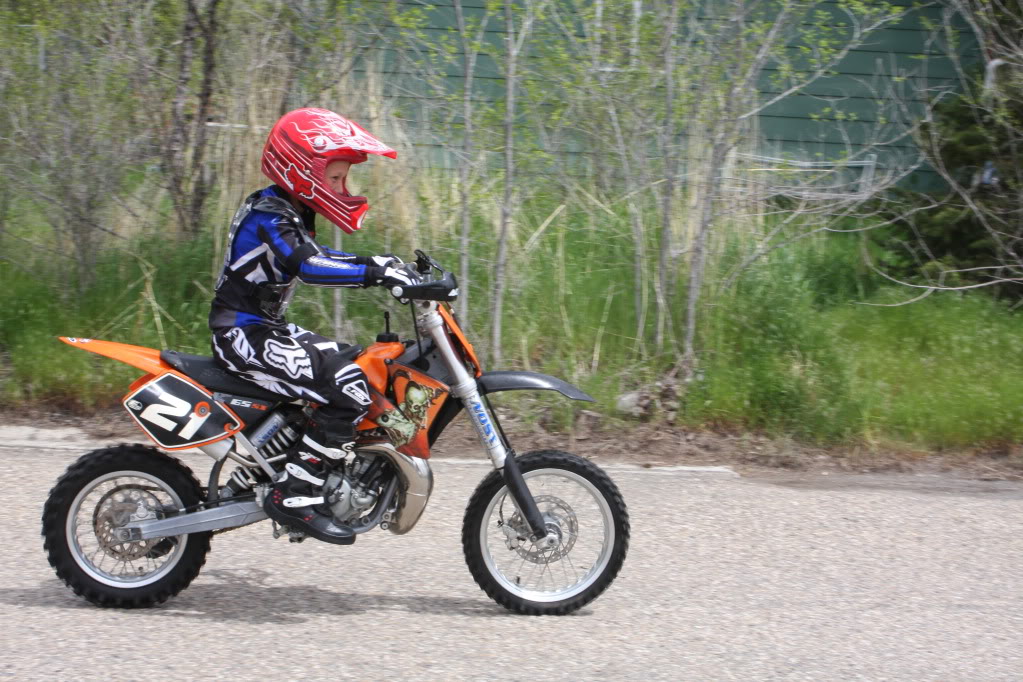

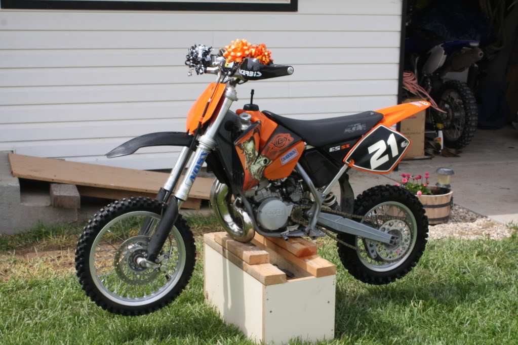

Here are a couple pictures of the bike and my son waiting to ride it again(Before we toasted it).
