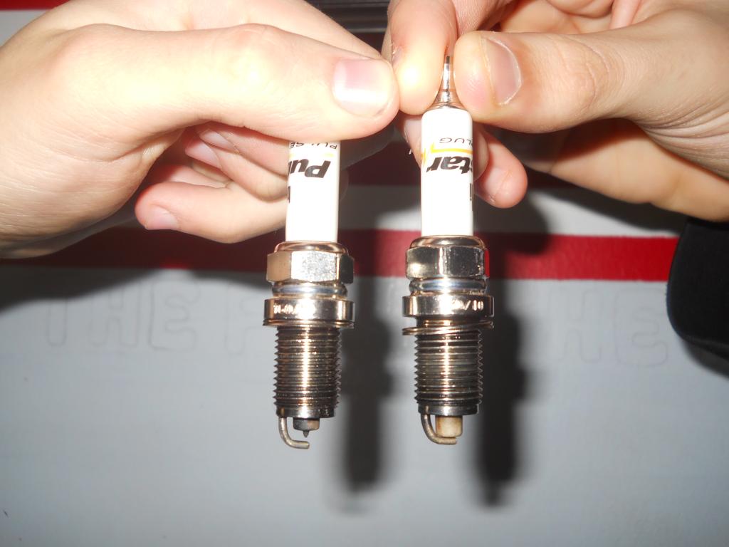

I have experimented with many different types of spark plugs. I have grown to be verry fond with Desno and NGK's. I have also tried a totally different style spark plug. One that was designed from a much older design. This plugs is called the Torque Master plug. Its a small company based in California. This plug does deliver what it claims as far as torque. But, longevity it does not. Then I came up across these new plugs in which were supposed to be part of the Harley Davision line. These plugs are called the Pulstar spark plugs. Let me say this These plugs are great and performed awsome in my bike. When I tried them. You will notice a performance increase in all power ranges. They were expensive yes. The bad thing is I found out that I could not trust this plug to not cause engine damage. The bike started spitting and sputtering when I was on the track. I was able to get back to the truck. This is what I found when I pulled the plug. The plug is a be1i Pulstar plug.
If you are switching heat ranges on your plugs, You need to watch the plug, and listen for pinging. Don't want to just throw a plug in and run the satchel off it. You could have a bad future. Everytime it pings/spark knocks.. It is just eating itself.
Hotter plug doesn't always mean more horsepower. And don't fix jetting issues with a spark plug heat range.
I understand whats your saying about the heat ranges. But, as far as the plugs I have tried in my bike. They were all within the same heat range. Well that's what they told me. These plugs just have a larger spark and burn completely. Check them out Pulstar and Torque Master plugs. Just read about them. I am not saying to buy them ok. I went back to my NGK BR8I iridiums.
