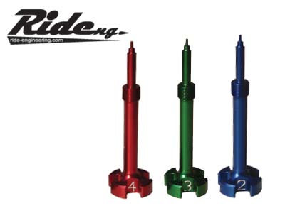

You're looking to put one of these in right?
If so, all you should have to do is unscrew the old one and pop the new one in. But I remember I had the same issue with mine, I ended up rotating the carb body so I could see better. If you have dental picks try using one of those to pry it out, just don't lose the spring and seal, as you need them on the new one.
