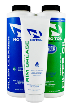

by far my fav product for my air filters is the no toil stuff.
as far as the oil and grease goes i guess its on par with everything else i have used but that powder air filter cleaner is a god send. seriously i was skeptic at first as all you do is pour some into a bucket of hot water and soak the filter. I was amazed how fast it cleaned the old dirty oil off. its like some anti grease miracle powder that makes the grease just go away or something. :lol:
It's actually oxi-clean. :thumb:
