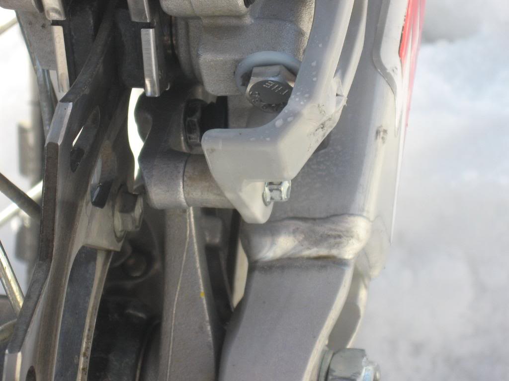

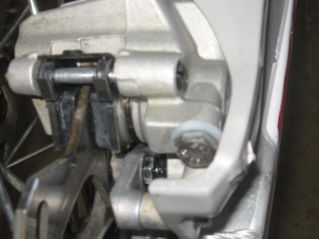

Thanks! Seems as if the compression went up slightly today, good thing I left a little room. My bike still needs a bath, either today or tomarrow. I'll get a couple pics of my valve when she get her bath.
Heres a good pic of my built out valve
