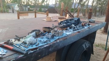

These are most of the parts that came with it

Heres how mine is going
image.jpgOk so i just found out that this head is ported too and i have no clue what ported head i should get or anything because i have almost literally no background on this or my local mechanic. This is the only cam journal that is damaged, it doesnt have deep deep grooves so i was wondering if there was any sort of way to repair these? I know there probably isnt but its worth a shot to see
I read you got the bike for 1k then you had to buy $900 top and bottom? Does that include a new cylinder? Also you have to buy at least 1 cam and head? What of the existing valves? After timing chain, gaskets etc (special tools) you may have gotten hosed by this "mechanic". If this was a moneymaker he would have built the thing himself in an afternoon and sold it as a runner for ~3k, which is what they are going for here, and what you will surely have in it when you're finished. Of course, knowledge is priceless and if you have that when you're finished, you're ahead, just not financially:prof:
Im not seeing any marking on the valves so im not to sure, but the head is only ported on the intake sideimage.jpg
Intake porting isnt going to matter. Im not seeing a lot of head damage beyond the cam journal. If the cam sits in tight I dont know if I would worry about it. I am curious as to what happened behind the bearing race that could do that. BeCu seats look ok. Whats up with the intake valve guides? They look weird in the pic
