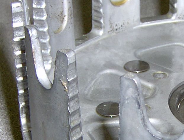

This sounds pretty normal, just pay attention to the clutch basket. Suzuki is known for getting heavy notches in the clutch basket causing lurching and all sort of other problems.
this is the notching im speaking of.
take a course bastard mill file and file the grooves out smooth... thats what the plates are hangin up on...
