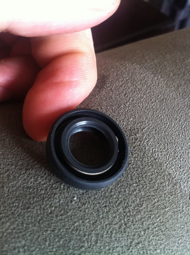

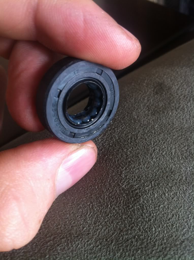

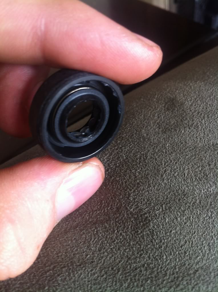

Coolant started dripping out of my weep hole, no problem, ordered the seals and gaskets necessary, but now i'm confused?
Which way do the seals go into the case, they look like this
And the outer side seal came pre-greased, I won't argue with Yamaha for that :)
So, which way do they face? I figured the side with the little spring would face inwards, while the side with the lettering would face towards the liquids? I tried a clymer exploded view, but that didn't help.
flat sides towards each other. The springs seal the liquid in, so you need a spring side out for the crank case oil and a spring side out for the coolant. I have to do this on my bike too.
Thanks NH and Jackson, just went and popped the seals/bearings in.
