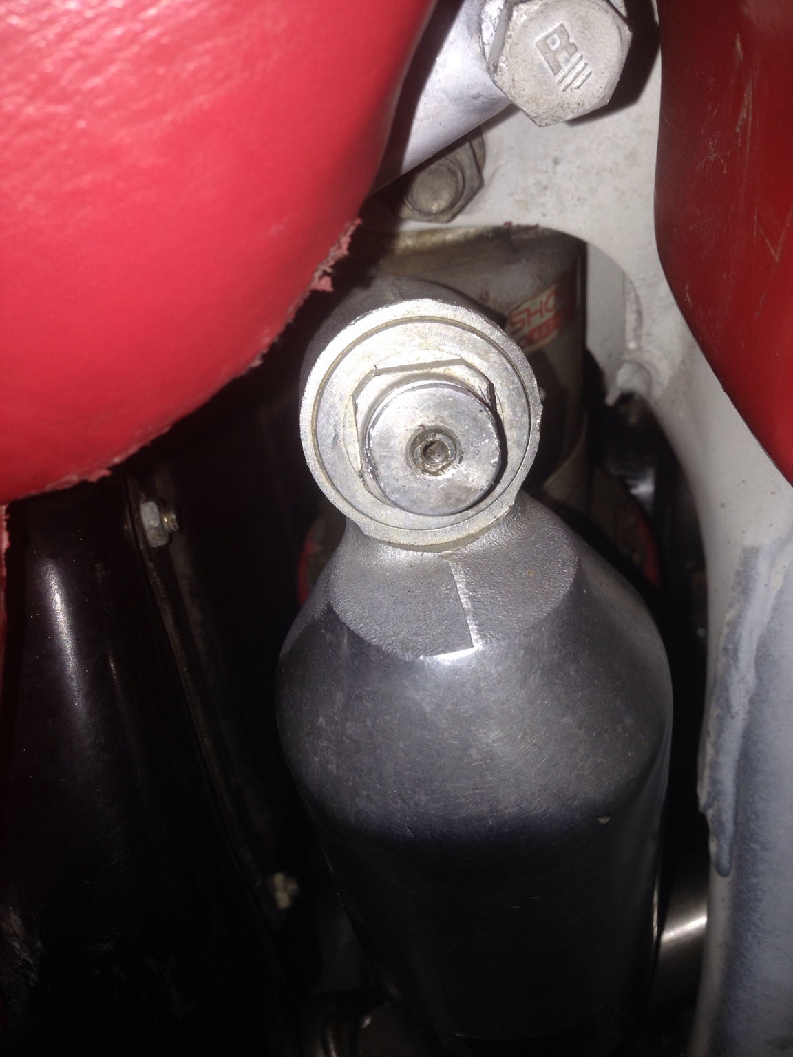

I buy service manuals and the tools then make sure I'm not guessing. I'm currently guessing and possibly right by saying the screw only holds the knob on and and the knob adjusts the rebound. I would also find the parts fiche to confirm this
It shows that to be correct. Can't find oem manual, but I have a clymer
Sent from my iPhone using Tapatalk
Theory correct. Here is the screw, out!
