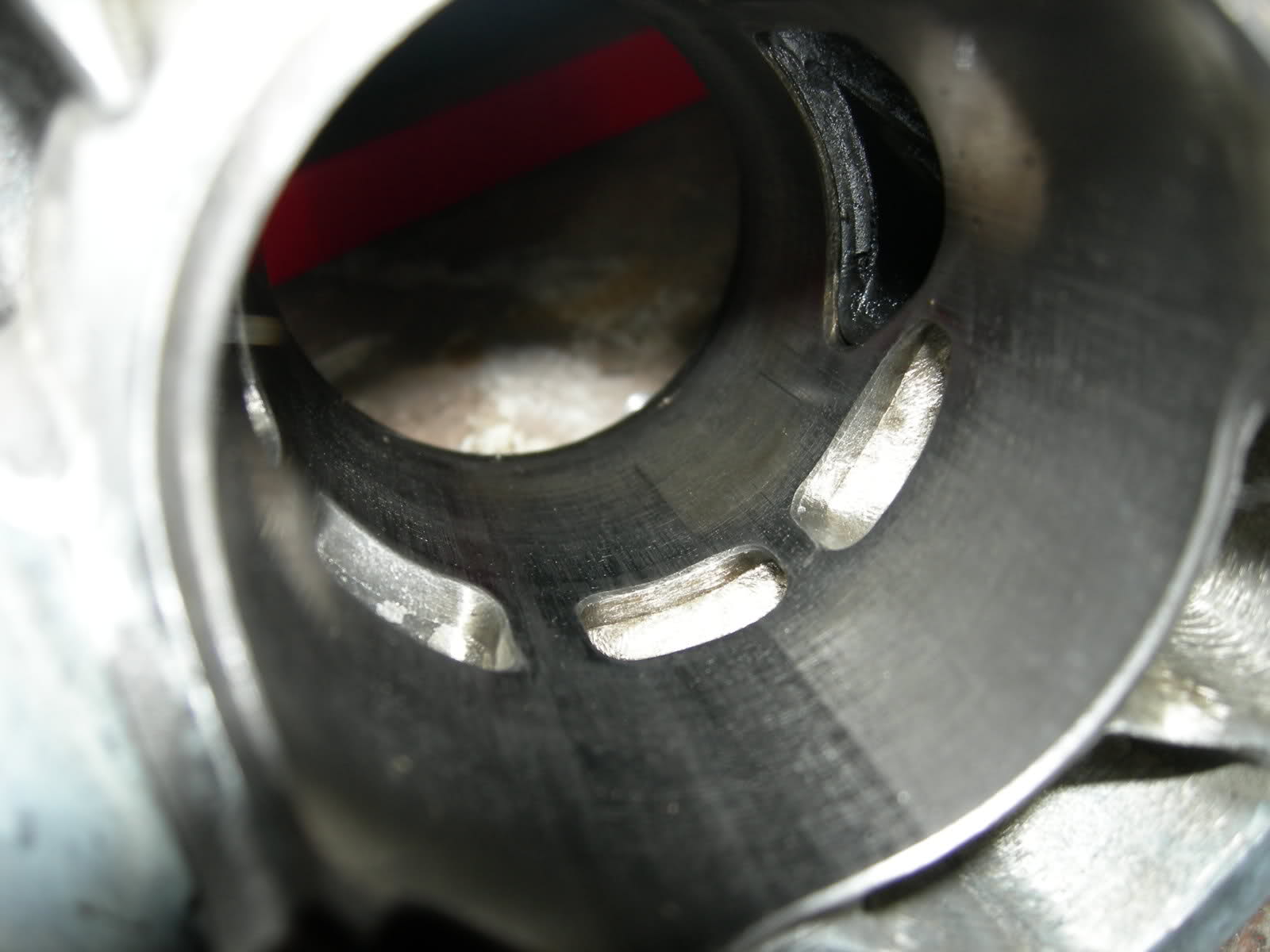

So basically i really screwed up when i re-rung my '94 CR125 last fall. Didn't check piston ring end clearance. :doh: Basically, seized so i tore it down, found out the clearance is off by .006" (six thousandths). So basically, what's my best option? I've thought about a .020" overbore, but would that require replating? I'm not sure how thick the Nikasil is on these things. Could I shave off .006" from my ring to make it fit? Thought I'd ask before really screwing myself up more here. haha

I was thinking that, but i'm not sure. God i hope not, that's costly haha. Here's pics of my cylinder though. I think it looks pretty good..except for one possible problem spot. Lemme know what ya think.

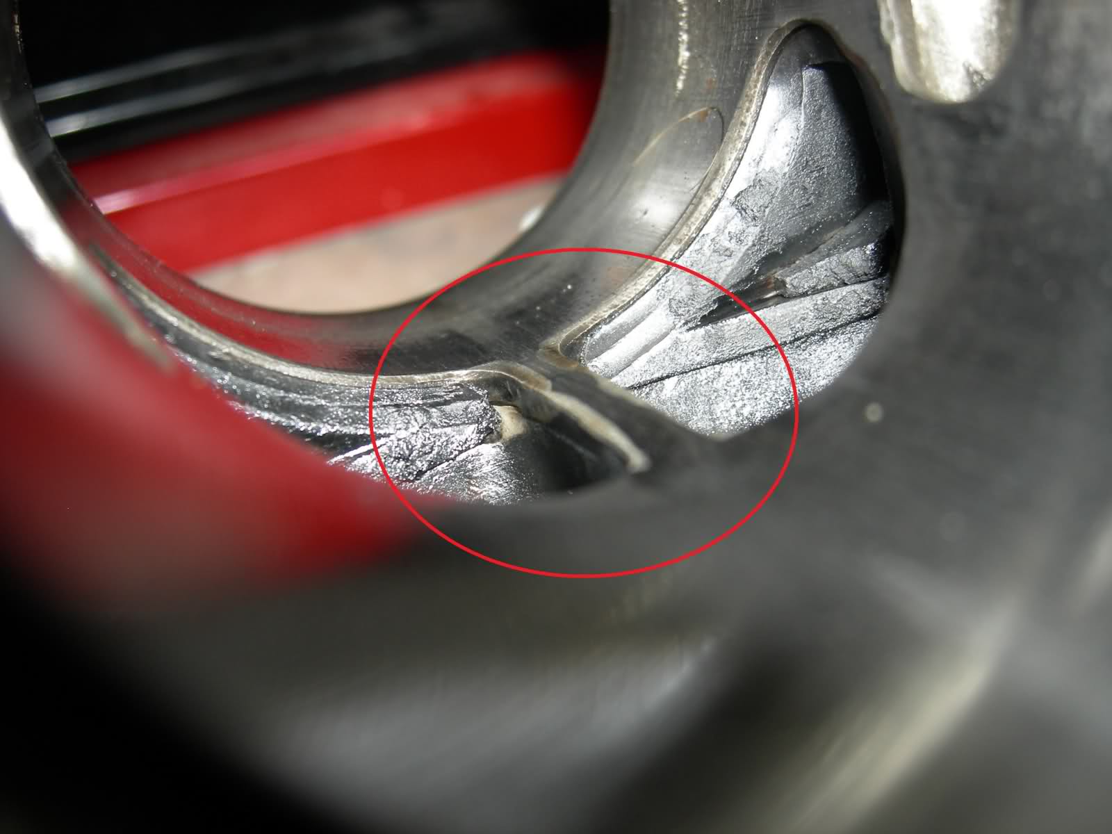

Aaaand, this spot here i think might be an issue..not quite sure.
Yeeeup. Well the guy before me did at least. haha

yep the ole famous exhaust port,, honestly some people relieve them so they dont make some much contact with the piston, I wouldn't mess with replating that. drill new holes or relieve it and your good.
Just came from a buddies house that bought an 04 with a fried topend.... same thing. his needs replating.... lol
