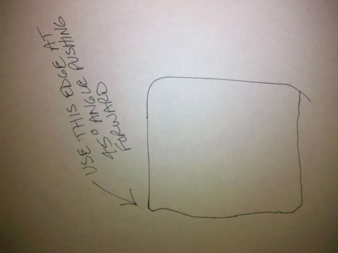

When you cut the soda bottle to get yourseal cleaner tool, try to cut a rounded hook shape into the corner that slides in and does the cleaning. It should look sort of like a comma with the rounded tip put into the seal. The tip is under cut slightly and this helps catch the dirt that may be the cause of the leak.
I had new seals put in when I had my susp shortened recently. One seeped oil from the start. I cleaned it after the first ride. Still seeps. Cleaned it again and rode it 350mi, it still seeps. Made a new tool like I describe above and I think I got it this time. No seeps in the garage now. If this doesnt do it then i will assume it was damaged on install.
Well, my dad is going to give it a go at cleaning the seals(as i am 330 miles away at school) He is confused on how to cut the bottle though...
