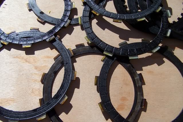

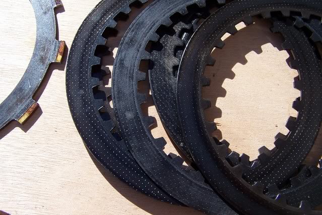

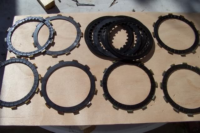

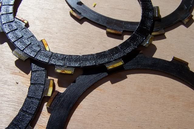

Heres one I cooked, nitrous plus shitty weak EBC springs takes a toll....
I was in the dunes right at the top when I completely lost all drive, I thought I sheared a shaft in the trans.
It stunk up my shed for about a week when I pulled the cover.
