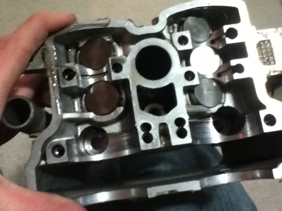

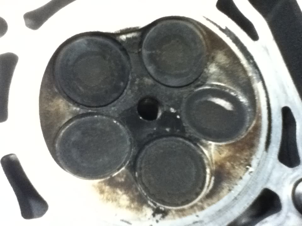

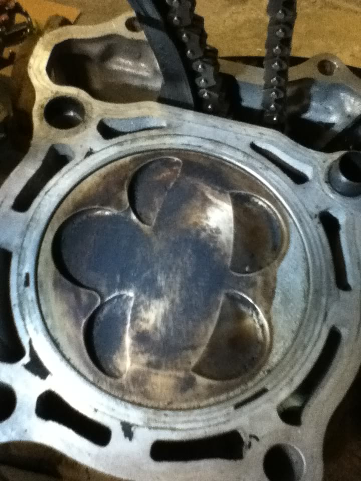

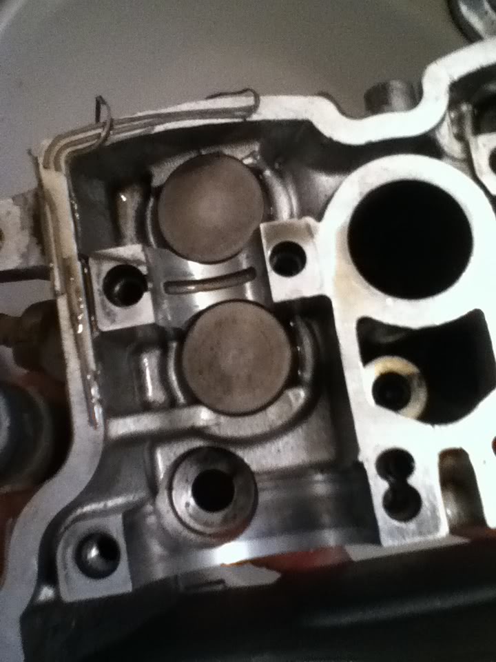

Alright I pulled off my head after about 2 hours of work and here are the pics. I did this because people have been telling me that my valves are probably recessed and that my valve seats and valves need to be replaced. Idk if you guys can tell or not from these pics, I dont have the valves out but will be taking them out tomorrow. I will probably have an update then.
Looking at your head, reminds me that I like a lot of butter on my TOAST. Seriously, if you just paid some guy to put in some used valves, I think you're screwed. You need to replace all 5 valves/springs/keepers/seals, and get the head inspected, and new seats cut in. I know what you're going through, my '07 is in the middle of a complete top end, and it isn't cheap. But I take solice in knowing a red bike would be on it's 4th or 5th go round, while this is my blue bikes 1st.:smirk:
And while it's down, change the piston/rings/timing chain, and measure your jug, and rod bearing to make sure they are still in spec.:thumb:
Ya its definately not. 500 bucks so far for new gaskets, piston kit, timing chain, and all 5 new valves and springs. And I havent even gotten to the price of cutting the valve seats yet. I also plan on honing the cylinder. Figured I would ask you since you seem to know a lot about this. I've heard quite a few horror stories about people honing and messing up the cylinder because it has a sleeve they didnt know about or something. Im pretty sure the cylinder is stock. With that being said, would it be ok to stick a hone onto a drill and start scratchin' it?

All the specs will be in your manual. The rod bearing is side to side. Get a feeler gauge and check it to your manual, if it's out of the acceptable range, you'll have to split the cases and do a rod bearing. If you do hone the jug, a very light go over with a ball hone will be good enough. Do check your cylinder for taper, and out of round, before you put it back together.
