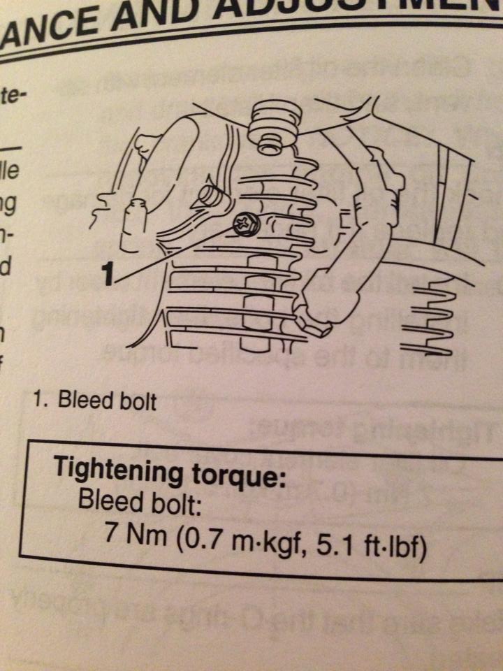

So the bold did not shear off cleanly. I took an 11 blade scalpel which allowed the tip to grab a bur on the broken piece. Once I got it started I took a small flat head screw driver and was able to oh so carefully back it out the remaining way. I did call one shop that was still open and they said 5-7 business days till the new one comes in. Gonna call others tomorrow and see if I can't one before the weekend so I can ride :ride: . No bolt means the oil will puke from the cylinder head till it runs dry and that's not good for any one :prof: .
Good question. I forgot to ask and on the cylinder schematic I can't find the exact one from the way it is drawn up. It's a cheap part too only 3 American dollars. Here is a pic from the manual:

hahaha yes I've learned that! Thanks for the help guys. I also found the part number once I zoomed out of the cylinder head schematic and realized how they have the motor turned (in the schematic the front faces you, on the bike it's the other way around).
